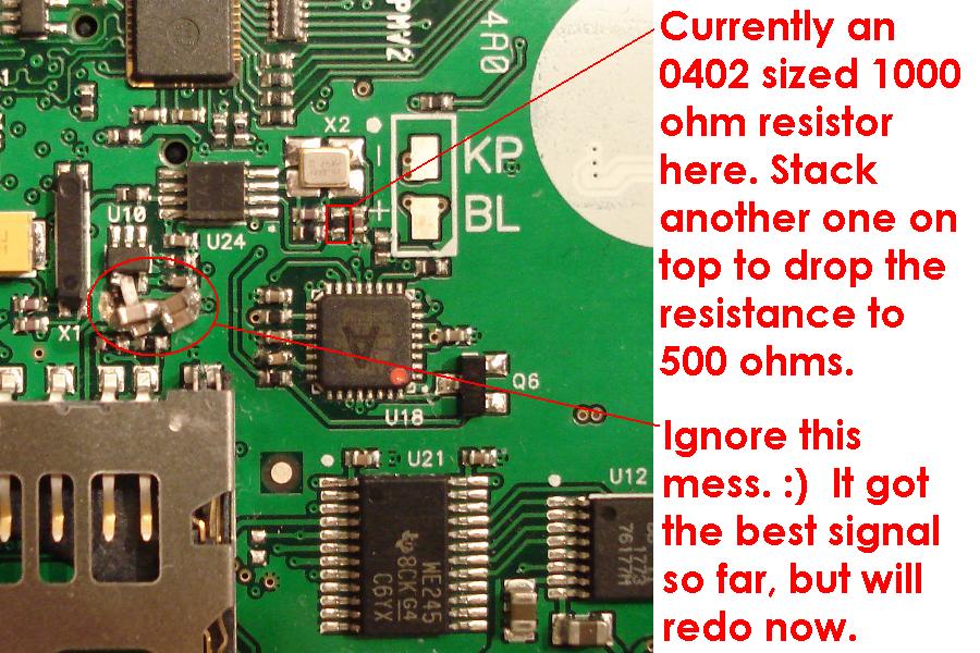

I think you, Farox and Dunny are missing the resistor fix, or have the fix improperly applied by Craig's team, so it's a hardware issue. See the image MWeston sent me back in 2010:
I could make another file in /sys/bus/... (or maybe /proc/pandora/ for easier use) that would enable the old behavior of toggling powersave on each packet. I don't have other ideas as the missing/bad resistor can't be detected in software.

Fixed.
@Notaz, I'm having a hard time ignoring that mess... my OCD is going into overdrive.

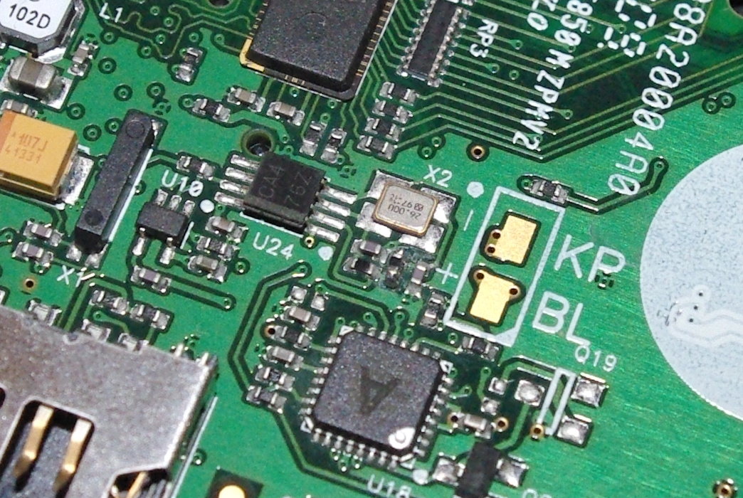

Well it looks like the resistor wasn't replaced there.
Here is how my CC looks, I think it was replaced by ED himself:
(edit: actually it's a stacked resistor on top, like MWeston recommended. These things are hard to see and photograph)
They should have switched to correct resistor for population at some point, but I don't know when.
I'll try to ask ED.
