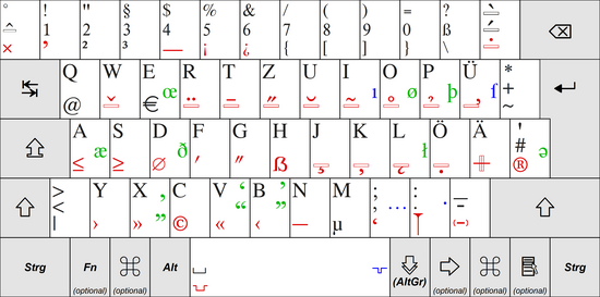

Speaking about Keyboard, who did choose to place "°" on "Q" and "\" on "B"?
Q + Fn is an easy to reach combination whereas B + Fn is not.
I don't see any use of ° but \ is used for programming quite frequently.

The only thing I don't understand is why ° is at such an easy to reach place.
What language does utilize it?
All I know it's degree Celsius that uses it but I don't think people need it that often.
\ Would have been a better choice in my opinion.

The only thing I don't understand is why ° is at such an easy to reach place. ... \ Would have been a better choice in my opinion.
Do you remember the problem in dosbox on the Pandora that you could not input | by typing Fn + b but had to type Fn+Shift+c because | is shift+\ on US ASCII and \ was on Fn+c.
The Fn layer on the bottom two rows of the Pyra was designed such that the characters and their shifted values are paired diagonally. So the Fn layer acts like a cheat-sheet for which key to press when this issue crops up. That's why \ could not be on the Q.
Even if you can use Fn from the shoulder button? I'm excited to finally not have to juggle my pandora to hit half of the function letters because now I'll be able to just move a finger to press Fn with my Pyra.

and you can always remap to have another \ on the degree symbol. part of the reason it's in that direction is that the degree sign is in the upper left area of a german keyboard. putting the umlauts over on the right part was also deliberate.

But Fn(Keyboard)+Q is so much better to reach for me than Fn(Shoulder Button)+B.

On the Pyra? According to one of the photos on the OP of this thread, underscore appears to be fn+D and minus is fn+B.
Looks like all of the compose keys you'd need for native french (/, \ and ?) are off the vowels, which is advantageous I think. All apart from ^, which is on FN+I, and I think there are a few words with a circumflexed I and you'd need to type fn+space (compose) then fn+I (^) then I unmodified to get one of those. A bit of a finger dance that I'd say.
Edit: And for my personal use, it appears that tilde (~) is on the shiften fn+i. That is just two shoulder buttons and the I key, but I'll have to see how well I can learn that. It might be better for me to use one of the usr keys as tilde.
