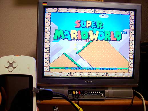

SiENcE sir! I want to thank you very much for your work! I'll share an image with you that you might enjoy ...
Playing mario on a TV. When fullscreen mode is activated, this looks absolutely beautiful ... pretty much exactly like what a normal SNES would look like.
If you are intending on adjusting the size of the screen so it doesn't get cut off by the Caanoo bezel, I also request that you also allow full resolution full screen mode as well! That way, when playing on a TV it still looks as native as it can.

:-) thx.
Yeah i also though it would be fun to attach USB-Joypads and or Wireless Joypads to USB-Host of our lovely Caanoo. One problem. I only have my old Snes-Joypads but no Adapter.
I can see a german Flag on your TV. So you are german ;-) ? Where can i get this Adapter?
This is the adapter i have, it works flawless on every pc ive tried it on (no third party drivers required, it just installs as soon as you plug it in). This is also a very common adapter.
http://www.dealextreme.com/details.dx/sku.11707
im not sure if they ship to europe though. Playing 2 player Super Mario World with TV-out would be so awesome!!!

Hahaha, nope, I'm not German. Though I did celebrate Oktoberfest out here in Tokyo! That was great. I'm from the US. My English friend gave me the TV ... I think he got the TV from someone else ... so, its been quite the community TV.
I got my SNES USB adaptor (and NES USB adaptor) here RetroUSB. Fun stuff!
