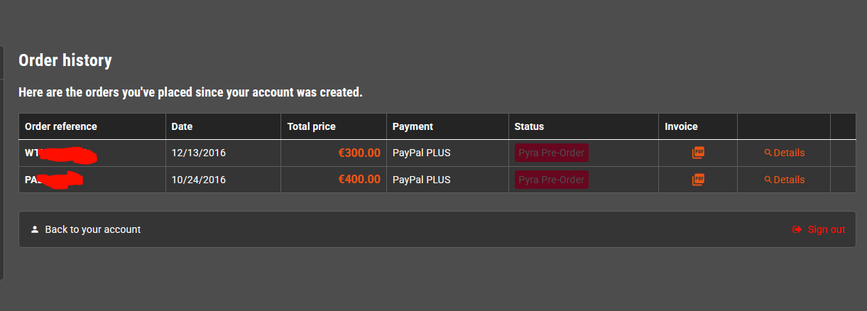

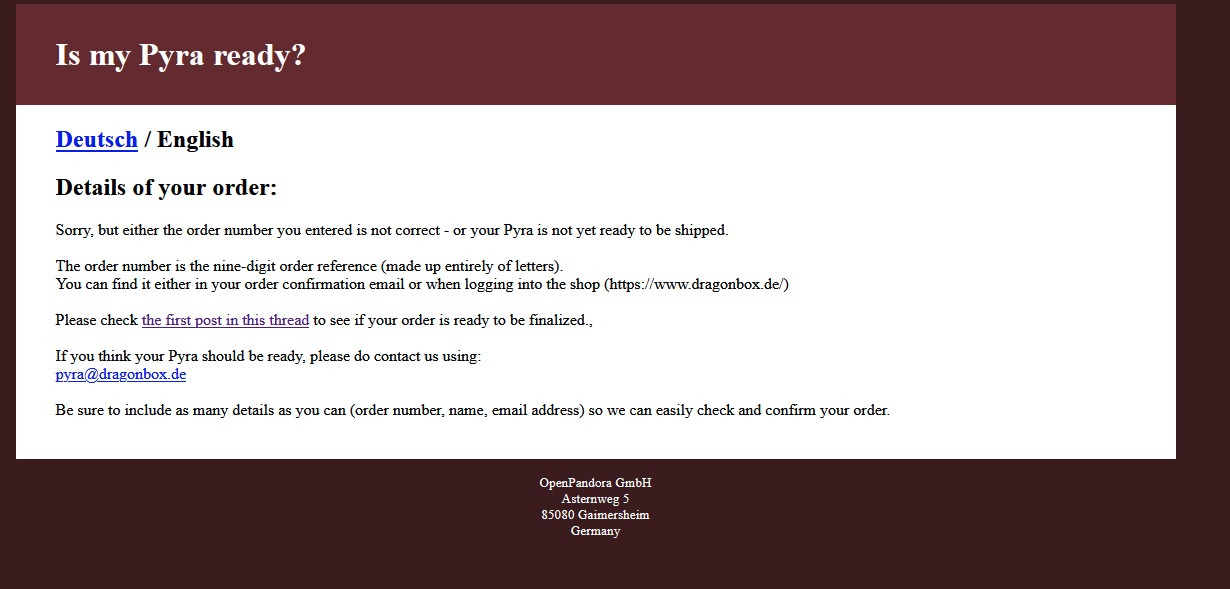

I ordered mind in August 2017. 8+ years ago. I finally emailed for a refund. Disappointing. No news either nor any emails. And the "Find my Pyra" system has never been able to find my order.
I don't know how well that site works, Just go to Dragonbox.de log in and find your order. Should say Pyra Voucher or Pyra Preorder or what not along with an Order ID.
