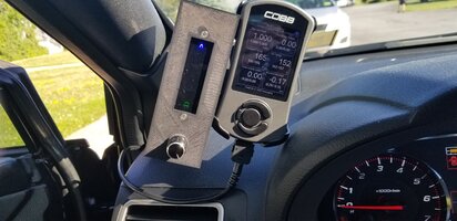

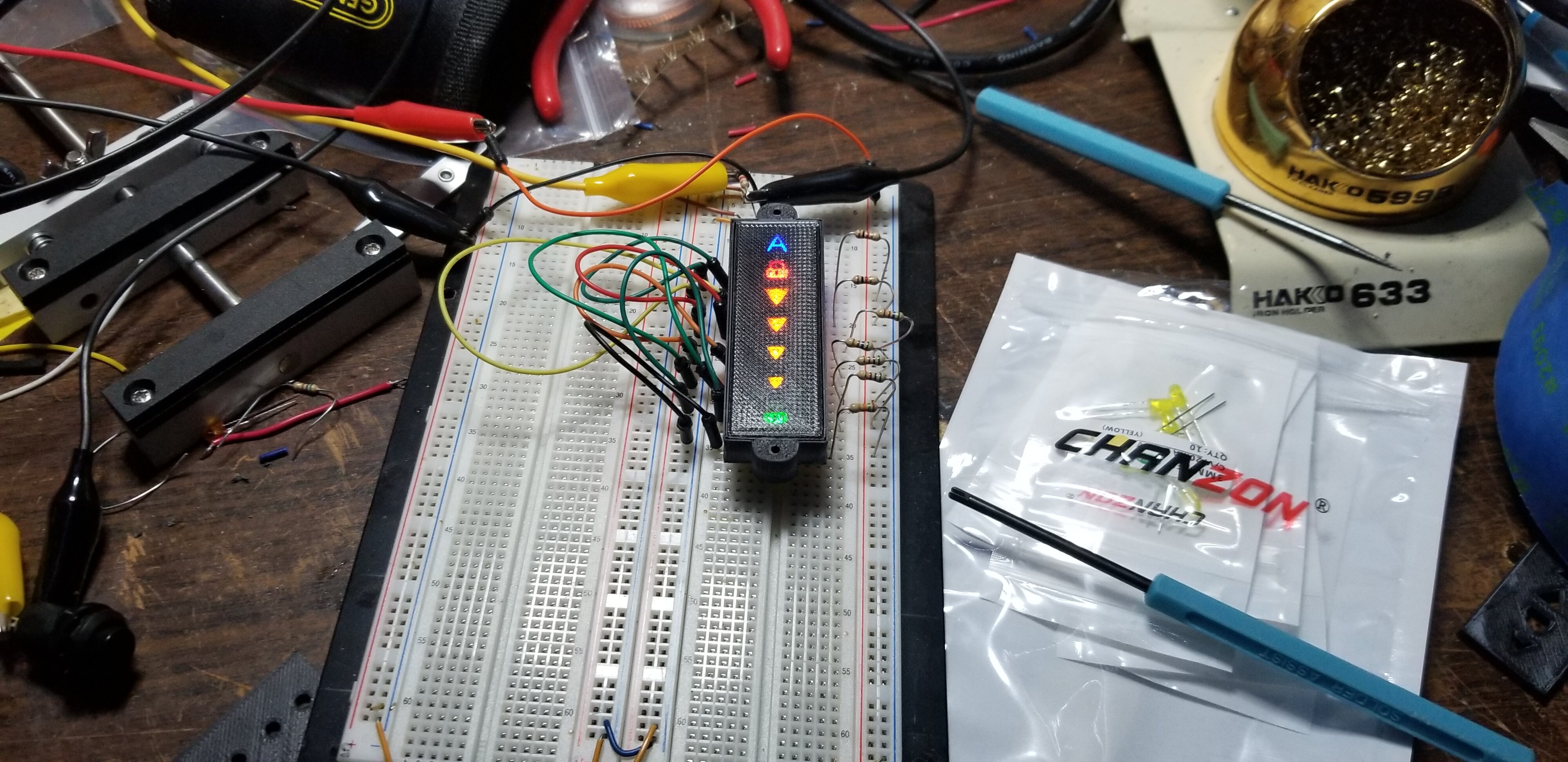

Odd project I just did for my Car, a 2019 Subaru WRX. Last year I had the entire 6-speed Manual Transmission and Drivetrain swapped with the STi version ( not entirely cheap, but feel it was worth it), which gives it a Limit Slip Differential and more importantly a central Differential that can be adjusted to lock by user control or automatic modes,It can go from a near 70% Rear to 30% front split with various locking amounts to a full locking mode that sets the power distribution to 50% Rear and Front wheels for gravel or extreme snow etc...
It's pretty nice, but since I have a WRX and not an STi I was lacking the dash cluster displays that shows the Differential Locking amount and I was running an aftermarket Differential ( DCCD ) controller that sits under the Center console, so I didn't have access to the controls directly on the DCCD controller without opening the lid on the arm rest, so not entirely convenient. Since it wasn't entirely straight forward to adapt the more modern 2019 STi controls with my aftermarket setup, So I did a bit of an electronics project to adapt the older 2004-2007 STi controls which utilizes the holes where the heated seat switches are mounted and since Subaru doesn't change much of anything for 20+ years these control switches just slotted into where I would have heated seat switches if I wasn't cheap.
As for a display, I pretty much implemented what would have been in an older STi a series of Lights that show if the DIffs are locked, and the aggressiveness of the locking, if it's in an Auto Mode or manual. I designed a simple LED display based around a dash cluster driver that was provided with the aftermarket MapDCCD differential controller, 3D printed an enclosure with PETG plastic that can handle temperatures of a hot car in the Summer. The display bezel itself Is using a multi material 3D Print using a black opaque to make the shape of the symbols and a transparent material to allow the LED light to shine through. I covered it with some black tinting material to clean up the display and hide some of the printing marks.
My goal is to eventually get rid of this Simple LEDs with a more advanced oLED display with more information and better looks, this is version 1.0. I'll need to get a display and micro-controller and program it to do cool things, that will take time.
Just some additional information adapting the original 2004-2007 STi controls to the Aftermarket DCCD controller requires a 0-5V Signal on the Thumbwheel, which I only had a 12V source handy, so I used a a TSR 1-2450 5V Switching regulator, one of those cool drop-in replacements for the 7805 that is really efficient and doesn't require a heat-sink.
Some early testing:

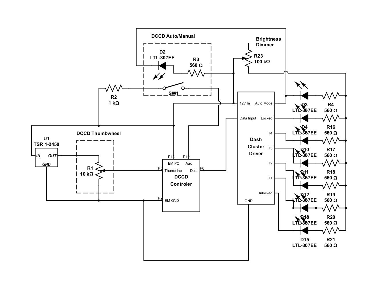

Quick circuitry layout I threw together:

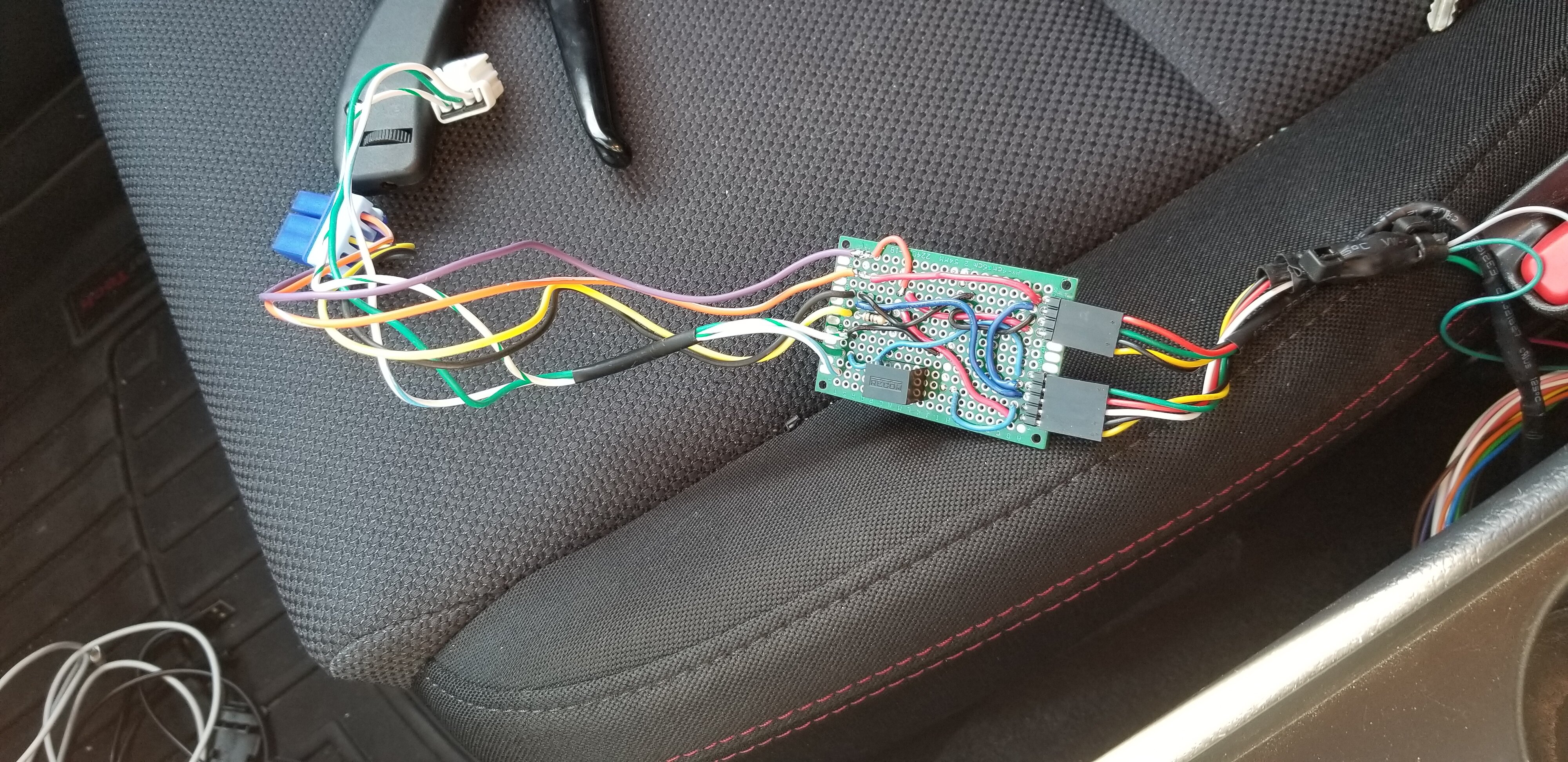

"Prototype" circuit board that lazily became final board:

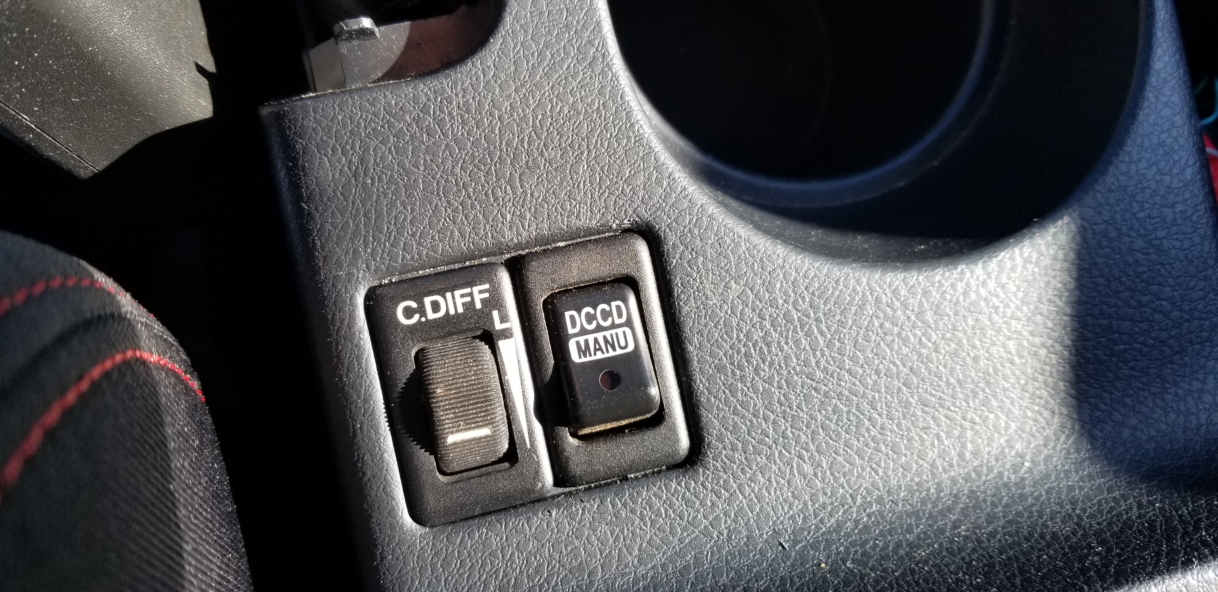

The 2004-2007 STi DCCD controls adapted in my 2019 WRX (direct fit):

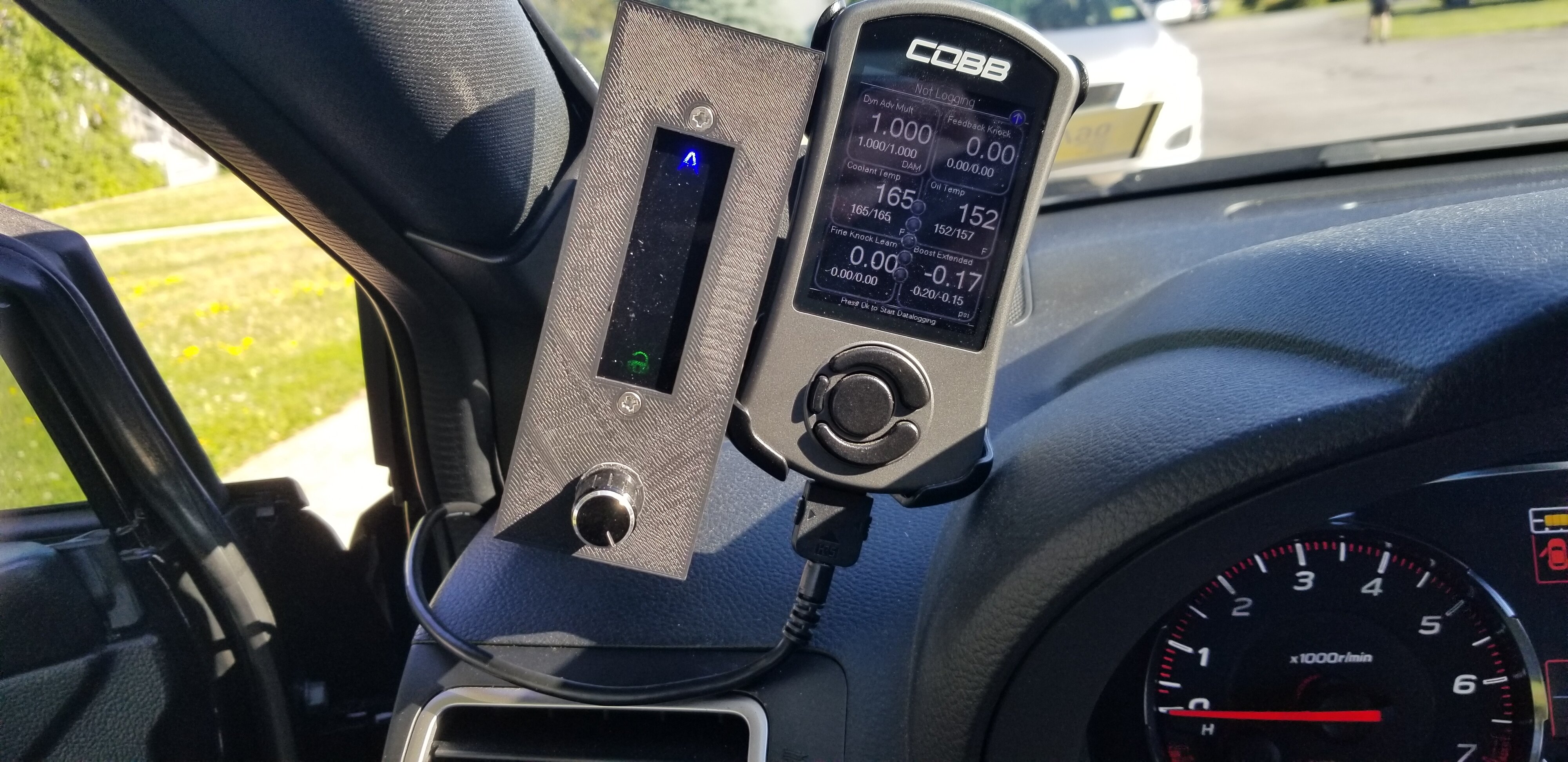

Picture of Version 1.0 Display (left)... Someday oLED with better functionality.
It doing it's thing:

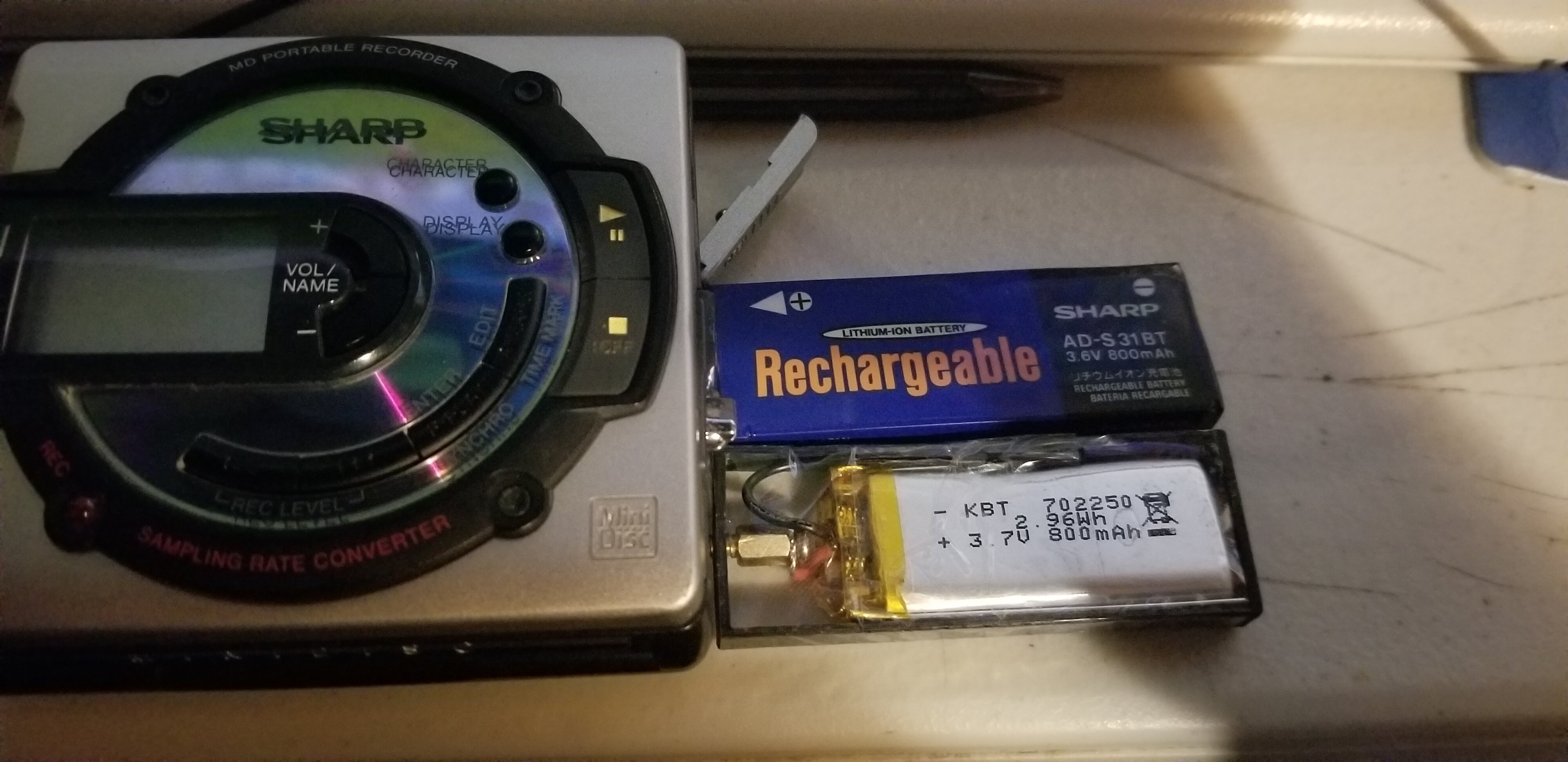

Well if your MiniDisc player's battery hasn't been Manufactured since 1999 you need to get a tad creative....
3d printed frame, from a design off thingiverse, had to narrow the sides of the walls to accommodate the battery I could source. Some copper foil to make the negative contact and an old computer motherboard standoff that makes the positive. And a little glue and tape..
The voltage is a little off but works well enough

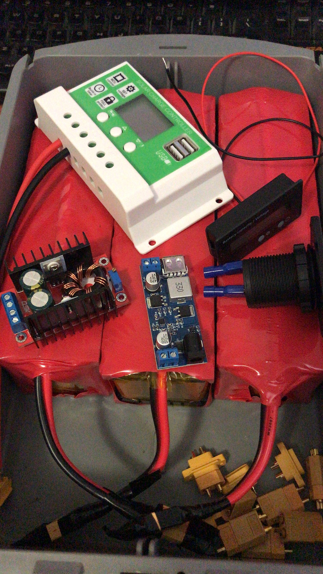

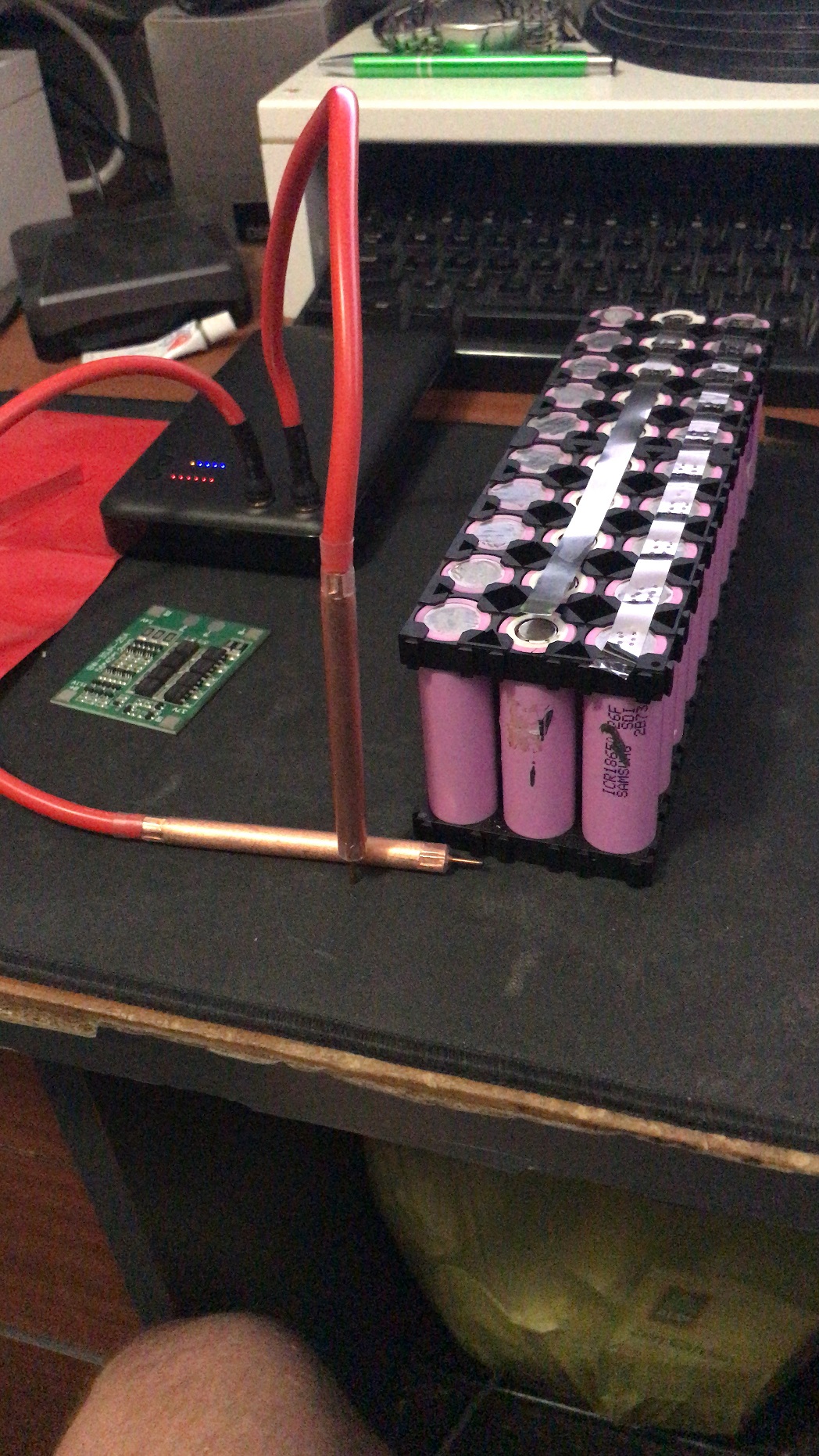

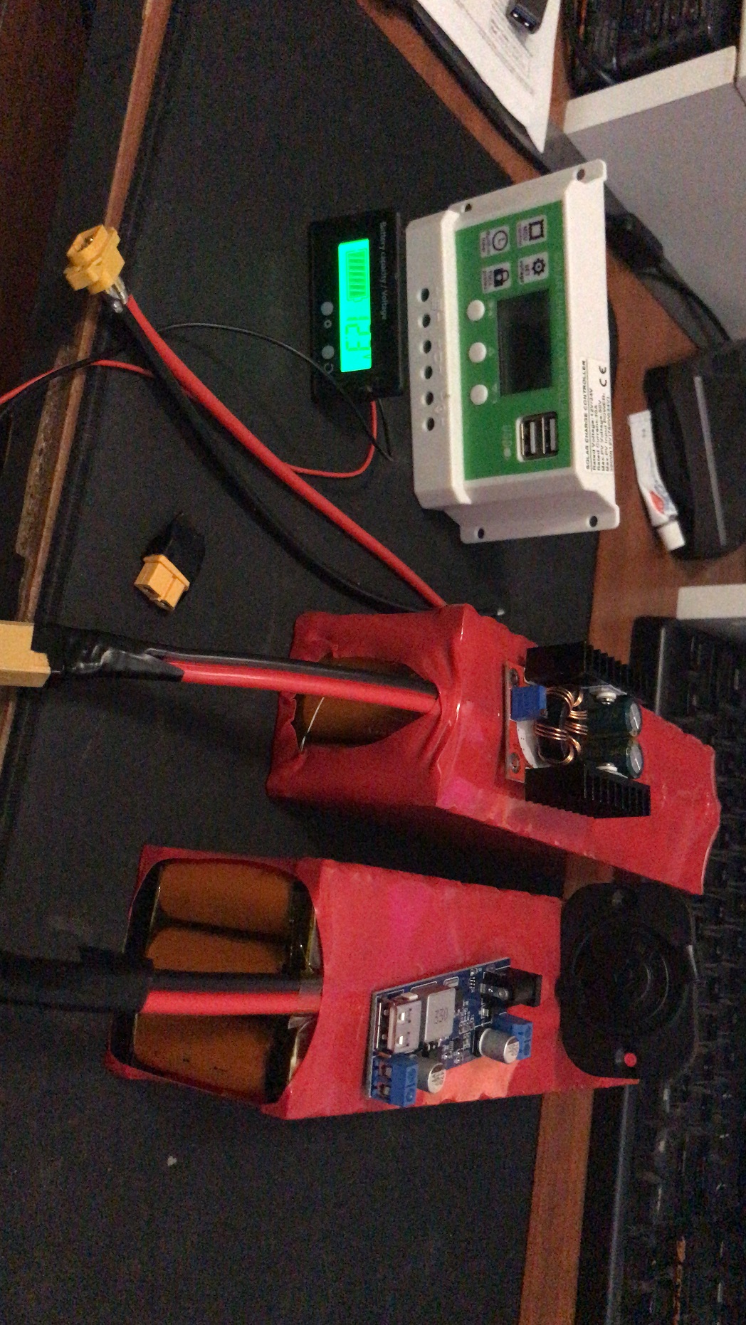

i got 15 Dell battery packs. 90 18650 cells. turns out all 90 were good. BMS boards faulty. so i stripped them out of the case and built 3 sets of 3P10S battery packs . last photo is during spot welding the nickle strips. Firdt pic is two of the packs wrapped. the middle picture is of the plastic box im putting them in. the will be wired in series to give approx 12V 75Ah . the board with the 2 black heatsinks is a boost conveter. This is to get 19 V to drive a monitor. the smaller board is a 5V 5A power board. this is to run a rasp pi 4 in an argon one M.2 case Rpi4 has a 256GB nvme SSD. plus there is a battery voltage display and a solar charger and a 12V cigarette lighter socket. this is going into my Suzuki Vitara to power a fridge and a 12V oven. so i can leave them on when stopped at jobs but still keep my drinks cool and heat up lunch.. all without flattening the car battery.
