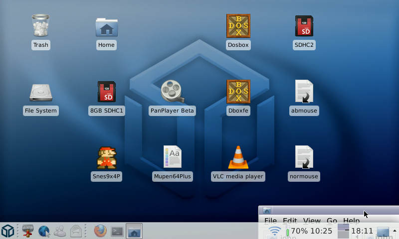

Use scripts, map them to shortcuts in your XFCEbar like this and change on the fly...notice the mouse icon and the joystick icon ;)

Then add launchers to the XFCE bar and point to the scripts, the icons come from the default icon sets for devices.
When you first set it up run the abmouse and normouse in terminal to make sure you have no errors to correct in your set up, good luck! :)

EDIT: Ok, think I got it. I made a launcher for abmouse in my home directory and gave it the mouse icon.
normouse got the joystick icon.
Is it meant to be the other way around?
Lastly, why do I have shortcuts on my desktop anyway? can I safely delete them?

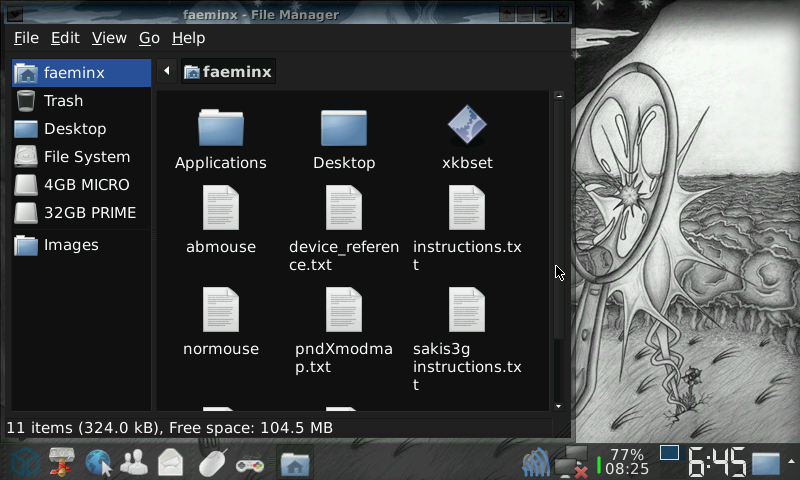

Is /usr/bin/ the home directory? In which case:screen110502-184553.png

Is /usr/bin/ the home directory? In which case:View attachment 494

Hi there...../usr/bin/ is a path where a lot of your binary executables and scripts reside. If you type $PATH in CLI (get to that in a second) it will echo your current environment's path i.e. list directories that are known to your session to contain executable files. You can add your $HOME to the path but for the sake of not having to do that I recommended adding the abmouse and normouse scripts to /usr/bin so you can just type and most likely tab complete the command in terminal.
CLI - Command Line Interface, this is just another way of saying type in terminal, xterm, or your terminal emulator of choice. When you execute abmouse and normouse in the CLI you will be able to see if any errors are present and correct them in the script or place the missing files if any in the place they are expected. Hope that helps you out a little; if not, ask more questions until you no longer need to......if after typing abmouse or normouse you get a "permission denied" make sure you have set proper file permissions so it is executable by sudo chmod +x /full/path/to/filename or drop sudo if already root for whatever reason.
EDIT: Just reread your post.....since you performed chmod 777 type this from your homedir in CLI sudo cp -p *mouse /usr/bin then you can create your shortcuts with the /usr/bin path or outright type abmouse/normouse in the terminal or "CLI"
