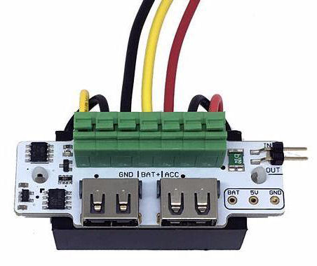

I want to use the Pi as a music player in the car (connected to the existing head unit via AUX in) but I don't want a screen on the RPi.
All I want is the RPi to play from an SD card (continue where it left off) when power is turned on and shut off when power is removed.
If I can add a couple of buttons for next and previous track that would be a bonus.
I know I need one of these to safely shut down the Pi but past that I can get no help on which music player to use or how to get it to continue when power is re-applied
