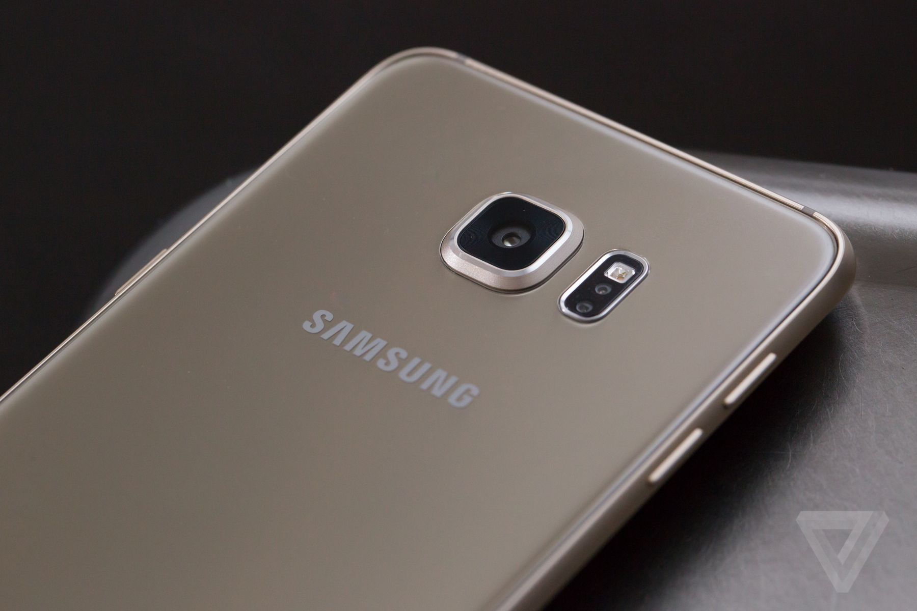

sorry if I am thread digging, this is my first post on the forum.
I was awaiting the pyra with high hopes of it becoming a all in one unit for me every day to carry for work and leisure.
A mobile device that can store all my PVC formulas (i am an industrial chemist) deal with customers via email calls and sms (i use a lot of picture messaging
when customers send me pictures of their machinery and their problems (from other suppliers of course!)
There are several things I do not understand.
Why is everyone discussing a camera as this massive marble sized object when mobile phones for over a decade have had cameras that are almost flat.
There is no doubt that we should be able to source a mobile phone sourced camera especially for 1500 units.
Something such as this
http://www.ebay.com.au/itm/Mobile-P...804219?hash=item2ef6f5df3b:g:B88AAOSwB09YH9ob
could easily fit into the front, the side or the back, if it was in the back you could easily program one of the should buttons to operate as the shutter when the lid is open or closed.
The other thing is, I cannot see why we could not have a seperate mic and speaker for calls in the base of the unit, the components are so small and cheap and there seems to be plenty
of room around the battery.
Everything about the design is perfect otherwise and I am still looking forward to the device.
I am not skilled enough with electronics to wire these components myself and program them.
...doesn't even include an objective lens, which takes the most space. Mobile phone manufacturers achieve such a compact form factor by reducing the circuit board to a minimum size, squeezing as much functionality into the SoC itself and all-in-one ICs as possible - leaving the whole thickness of the device available for peripherals and often sacrificing quality everywhere.
The community has decided to use a classic LCD screen with dedicated backlight instead of a slimmer OLED screen, the community has decided to not ditch the full keyboard whose PCB covers almost the whole base of the device, the community has decided it wants audiophile sound quality with proper dedicated components instead of using crappy integrated all-in-one circuits, the community has decided to use full-sized SD card slots instead of tiny micro SD card slots - and last but not least, we have a dedicated replaceable PCB providing the device's core components, which has to fit between the battery and main PCB. The case really is already stuffed, it wasn't even possible to add a dedicated S-ATA port to the back.
If there really was space for a proper camera, it would be a really inconvenient place. There are already several lengthy discussions about this topic, as well as several sound reasons not to include one by default.

The critical difficulty with a camera is it's thickness. If you take apart a typical modern smartphone, you'll find that the lens assembly takes up the full thickness of the device, and often sticks out slightly. (use your favourite search engine to look for images of "smartphone camera bulge")
A lens assembly big enough to give tolerable image quality would be thicker than the Pyra's lid - and the Pyra is already a pretty thick device.
There might just be room for one in the base, but where? The sides are covered by your hands, the front and back are covered with connectors (apart from where the 3G modem sits) and the back has a battery in the way.
The only place where it might have been possible to put a camera would be in the keyboard area, facing up - which would only be good for photographing your own nostrils.
Cameras are tricky things to design, because of the strict lens geometry requirements, and the high-bandwidth data connections they need.
Aside from those technical reasons, there are also privacy/security concerns, and people, (me included) who don't really see the point of a camera which can never be more than mediocre.
This isn't to say that cameras are bad, or that the Pyra is better without one (although some people would say that). My point is that the idea of putting a camera in the Pyra was considered, and rejected for sensible reasons.
