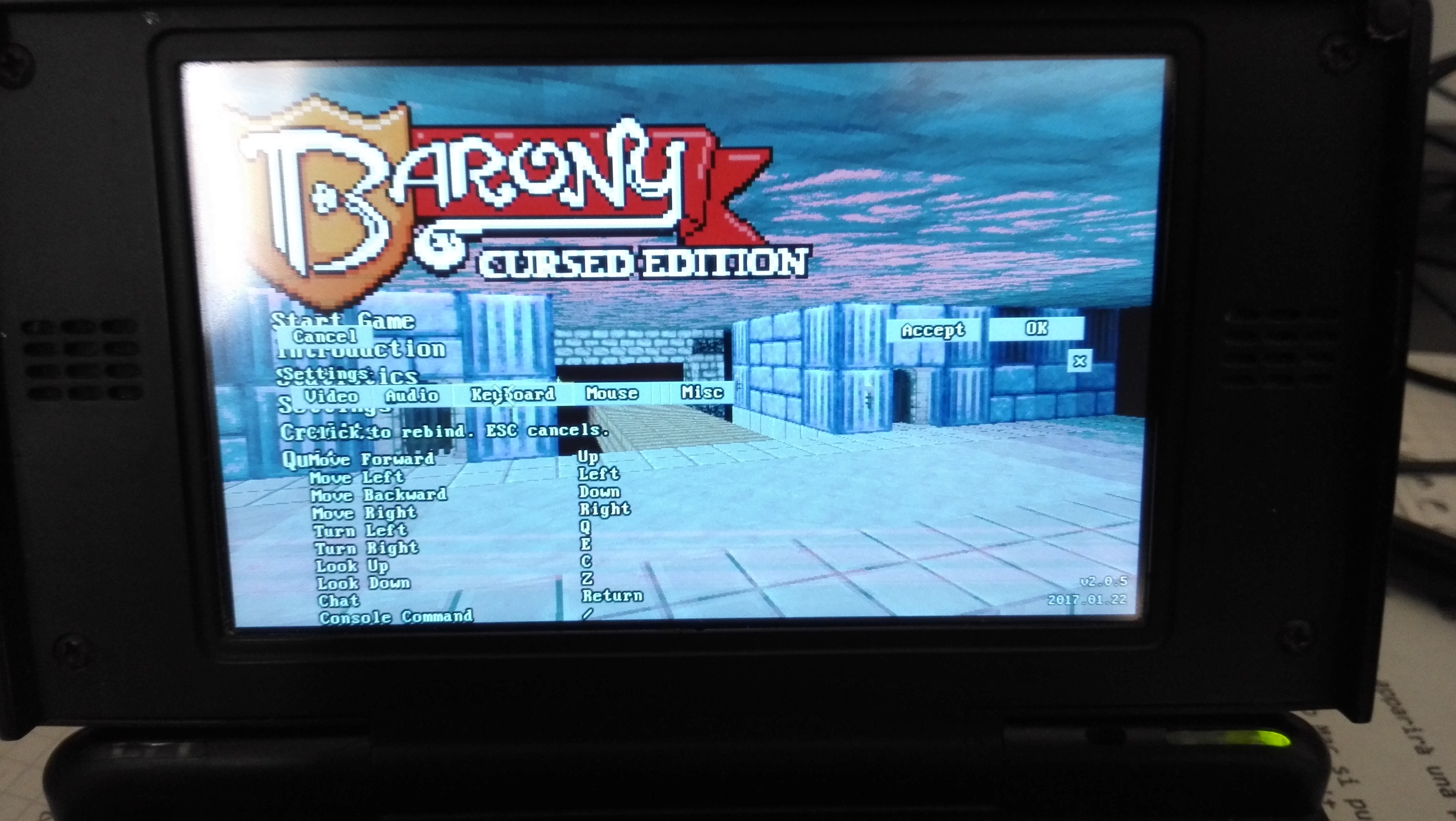

the options menu is the same as before...i attach an image to show:
Mmm, thanks for the picture. Strange, you have the unlabeled menu between "Mouse" and "Misc", meaning you don't the updated lang/en.txt in the data (it should be automaticaly copied, and it worked on my CC when I tested).
