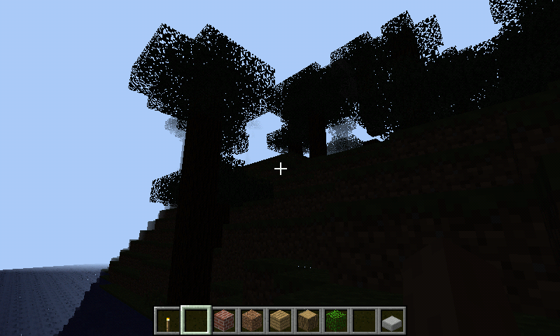

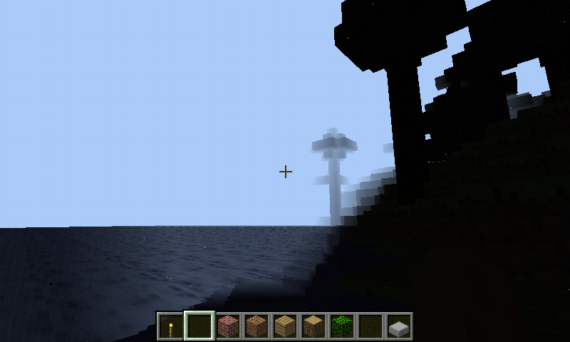

Not much progress in fact. I still have (almost?) no texture on the cubes (maybe it needs Compressed Texture support?)...
I have redone parts of the List, but it hasn't fixed the issue... Framerates goes from 1~5 fps (rough estimation, not a real number).
So, I added some basic DXTc function, but it doesn't use them... But I activated the "fancy" graphic settings, and in fact, I don't think it's a texture issue. It's a Lightning issue IMO.
Look at the tree, with the Fancy settings, you can see thru them, indicating that the texture (with the holes) is loaded and working fine.
So lightning or Material issue inside glList I guess.

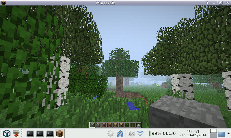

On old version (like 1.2.5), there are texture not black :) , but fullscreen option is gone :(
