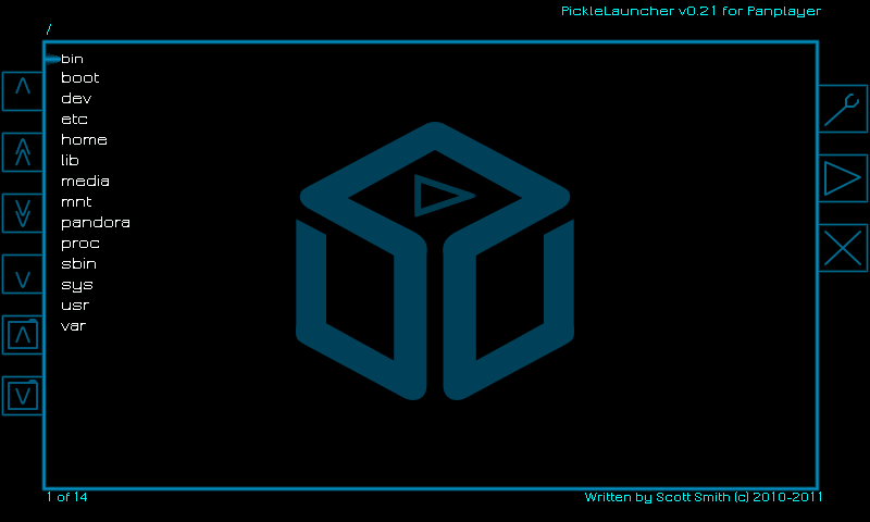

All right, update time, finally finished the skin, and I do think it turned out quite well. Also been working on a new PXML file, and I will try to use the functionality of associations, so I can set it to be able to play back files chosen from the file manager, hopefully that will work all right, I also discovered my earler fix for the subtitle issue didn't actually work, my mistake on that part, and been working for a while to try to fix it, also built regular mplayer just to try it out, and it's able to playback real media files, which mplayer2 couldn't handle for some reason, and also it actually scaled the video right for playing using omapfb, but it has it's own issues, with for some reason for some files, it will get very, very choppy, think it has something to do with frame dropping and the audio and video getting out of sync. Been trying to pin down what causes it, but not sure, so I've been debating whether to use mplayer or mplayer2, as each has its pros and cons. If I use mplayer 2, I'll have to either use the vf expand way of making sure the file looks right, and doesn't get it's aspect ratio screwed up, or use mplayer, and see if I can figure out why it was having that strange condition. No perfect solutions, as with anything else. What I can do is to show you what the new skin looks like in all it's glory.

Success! Everything works fine and dandy now, it still won't support rmvb files, but I'm not sure how many would try to play those in the first place, will be removed from the picklelauncher listing for now. Only slight issue is that using omapfb there is a 1 pixel wide gap on the left and bottom sides, I tried to fix it, but couldn't get it to work, but it can be fixed by pressing f twice if you really care about it.

Okay, final test before I put it up on the repo, I'll wait a few hours, and put it up on the repo tonight. Hopefully this will work all right for everyone. :) . Let me know of any issues and such. Have at it. :)

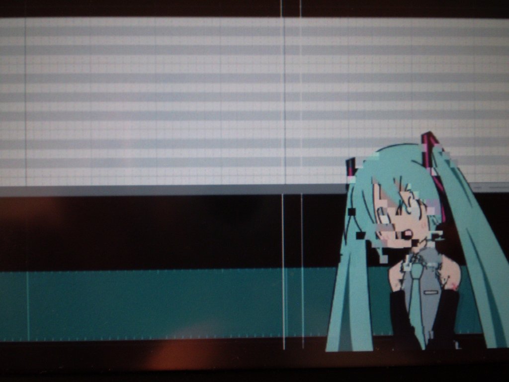

Only issue I found was with mkv/theora playback.
Not sure what it's related to.
You could try removing within the mpconfig.conf file the fast=1 part of the lavdopts line, see if that helps anything.
Didn't help.
Weird, I converted these with HandBrake from h264, but they work in VLC.
Would be better if someone else could confirm this, though mkv/theora doesn't seem to be a popular combination.
Yeah, I did a test with a theora file, and it seems like mplayer2 has problems with theora, though even with regular mplayer, it was still a bit corrupted, so I think it's an underlying ffmpeg issue, not surprising considering I pull from the development branches, these kinds of bugs pop up from time to time.

Yeah, I changed it to L/R, thinking that I could still get the same functionality with the back button, but I was wrong, I've since changed it back. I prefer it to be the way it was, unless people like the new bindings.
Haven't checked out the latest build yet but I ran your preliminary version and bar the need for bigger buttons, touchscreen response and such like, which you have worked on and nailed already in but a day, its was awesome. Really nice to have an update to this media marvel and the new skin is more than just a brand spanking new integumentary system and is truly a beauty to behold in everyones eyes I am sure. Thanks for all your work, its appreciated :)
