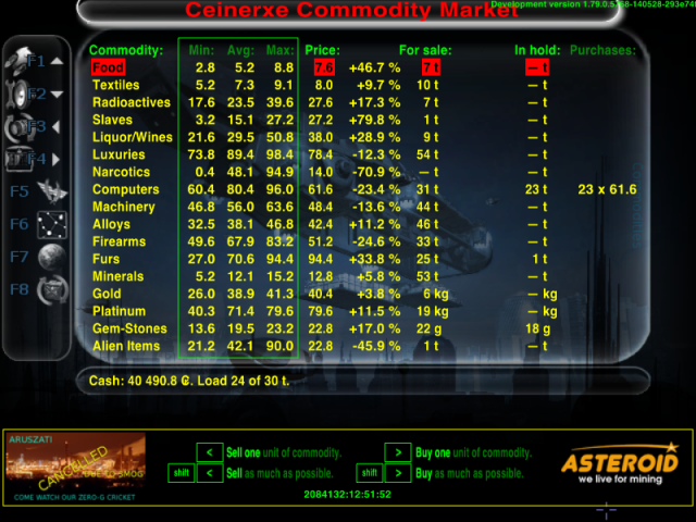

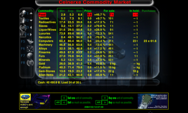

Only problem I've seen is the prices in the markets seem very low - likes sub 1cr low. And the percentages reported by the market observer OXP seem off too, reporting postive percentages for such low-priced stuff in places. I'll have to retry it later and see if I can reproduce it, and also try disabling the market observer oxp, but I'm a bit short of time today, so I thought I'd drop this here note on here and see if anyone else had seen the same. Nothing in my pndrun.log fwiw.

I was checking the manifest sales market screen after Levi mentioned wierd prices, and also found something wrong. Using exactly the same save-file and OXP's added (and all removed) brought out totally different values, as though the pandora PND code is a bit squew wifff, with the same save-file etc, this is the PC screen
And this is the Pandora screen with the same save-file etc

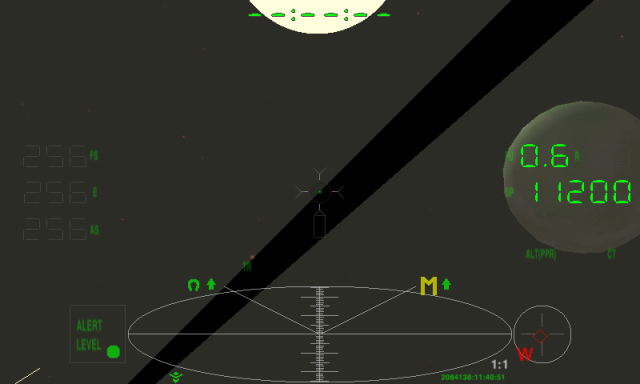

Also i don't know if this is relevant but the grahics have a few issues, such as witchjumping, its, not show in normal darkness but with the sun light it shows up lines across the screen such as this
this is most probably due to the new sun aura thing in 1.79, but i do't understand the differences in the prices on the market with exactly the same details used
Hum, market prices are stange yes. I'll recompile the version tonight, double-checking the optimization option to be sure they are not too-agressive.
For the graphics bug, yes, it's probably related to Sun Blind code.

About the Price Market, One very strange thing is that the price are just the Decimal part, the interger part is forced to 0... End if look well, it looks like the real price is correctly taken into account, not the 0.xx price. Very strange.
I recompiled Oolite, but still the same.

I can confirm that if you buy any of the 0.0 listed goods you really do get them for free.
While I had the chance, I took a few snaps of the transparent triangles glitch.  On the left is the same Cobra Mk 3 with half of it's rear end and most of its front end missing, on the right it's intact.
I could only take the snaps from the middle distance.  Getting too close meant the textures filled in, so I suspect it's a rounding error.
This glitch has been present since the first version, but now shipping with a more complex shipset as default means everyone will see this glitch quite regularly.  Doesn't really spoil the game, but it's pretty obvious.
I still must have some well hidden bug in glshim somewhere :( , or it's a "fast-math" side effect maybe (because of the angle of the missing geometry).

I have fixed the Market issue, updated to v1.80, and try some things for the OXZ Manager (but I don't know if they works as I have no issue on my side).
