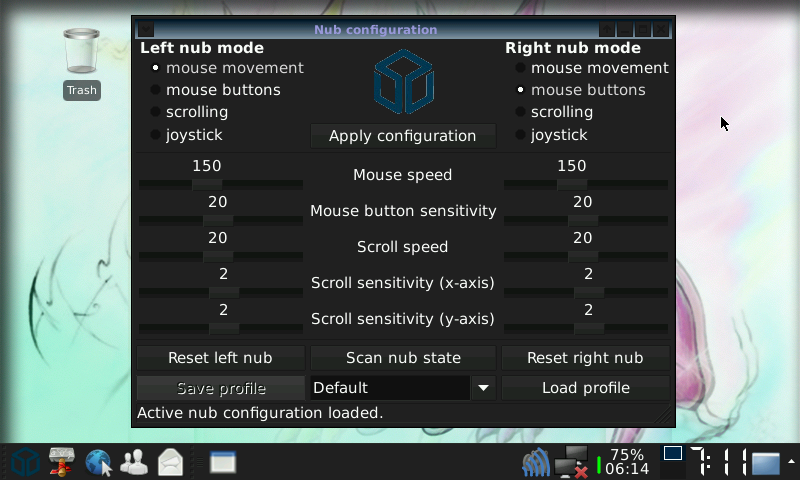

Here is a small python script which provides an alternative way to configure the nubs of the Pandora.
I didn't really like digging through the nested menu structure of the nub settings configuration script so I decided to create a tiny project to replace it. It is mainly a play project to learn a bit of GTK and PND creation, but I decided to share it anyway as someone might like the outcome.
This application presents all the settings for both the left and right nub in a single screen. It allows saving and loading of the configuration as a profile to quickly switch between common configurations and also provides command-line options to incorporate that behaviour into scripts (although passing parameters to PNDs isn't the greatest user experience in the world).
I did encounter the issue that writing a value to /proc/pandora/nub0/scrollx_sensitivity actually stored a value one lower (if positive) or one higher (if negative) instead (this also holds for scrolly and nub1). The default nub configuration script /usr/pandora/scripts/op_nubmode.sh is also affected by this. I worked around it by adjusting the values accordingly in the opposite direction though the behaviour itself seems a bit odd. Is it intentional?
Anyway, feedback and/or feature requests are welcome.
PND file
Preview image

I don't have my Pandora yet and don't know how the build-in configuration works or looks like, but from the screenshot your PND looks really nice and very useful.
What does the "Reset"-button do?
Is it to calibrate the nubs? Otherwise such an option might be useful a addition (if this is possible).
I copied over all the functionality from the original script which does the following:
Code:
echo 1 > /sys/bus/i2c/drivers/vsense/3-0066/reset
sleep 1
echo 0 > /sys/bus/i2c/drivers/vsense/3-0066/reset
My estimate from this is that it is supposed to reset the driver. Unfortunately, (and this holds for the original script by ED as well), you need superuser privileges to do so, so currently it doesn't do much more than throw a Permission denied error :p

It toggles the reset signal to microcontrollers, so they are reset.
You could wrap this in a small .sh script and start 'gksudo reset_nubs.sh' when reset button is pressed. This way your GUI would start without asking passwords and only ask first time reset is pressed.
Also the reset signal is shared by both nubs, so one reset button is enough.

If I can use it, I will include it in HF6 Alpha 2 :)
Caine: I will take care of the permission errors, so just keep the reset nubs features in there :)
It's a bug, for which I've just commited a fix, should be there in next HF build.
Good idea. So setting vsense/3-0066 and vsense/3-0067 has the same effect. Hmmm... I'll probably keep the dual buttons though, ED had a feature in his script which allowed you to test the nub and I want to add that as well.
Alright, then I'll make a version with my fix removed.

You can also detect it at startup by doing a quick write and read. This is just a variable in driver and does not affect hardware, in case you are worried about chips not liking too many writes.
