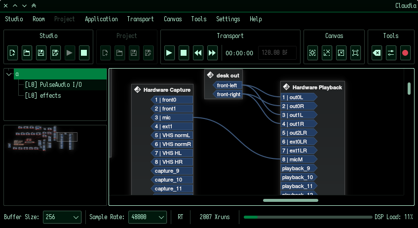

Autian
Jul 19, 2017
53
Germany
One may try to use JACK to test each channel individually, as demonstrated in the following example:
"desk out" is my PulseAudio sink and Hardware Capture/Playback speaks for itself.
with plugin packs like Calf or LSP you can also do some complex audio processing stuff.
It is somewhat fiddly to set up overall, I never got it to run stable on my desktop PC (sometimes crashes out of the blue or freezes). I am using the cadence-claudia (for configuration and for loading plugins) and jack2 packages in Arch Linux. The cadence-claudia from the AUR has the routing application as seen here compared to the regular cadence package.
I don't know if this is helpful to you, hopefully I gave you some ideas here.

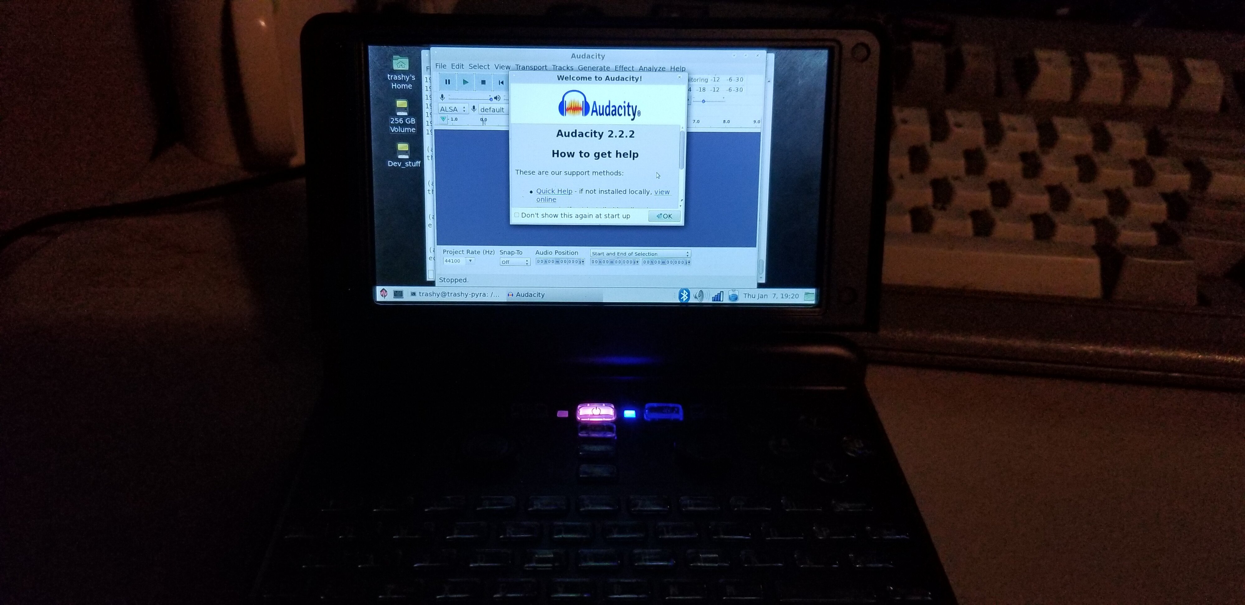

92
If Audacity is working already on the Pyra that would be another good way to test audio.
Would be also interesting to play a sine wave from the left speaker at the same time as the *inverted* signal from the right speaker.
If both channels are played correctly, you would notice weird phase effects as you move/turn your head.
If the channels are being "mixed" then you would hear nothing at all.
