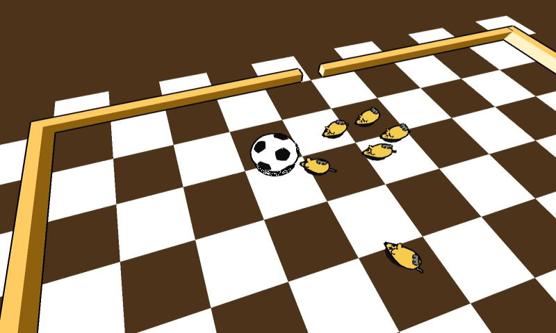

Here is another port of a demo from Fit & Bandwagon.
Is called Micery and was an easy port thanks to the authors that coded in a multiplatform way:cool:
This demo run thanks to GLshim (i use the very latest revision from ptiSeb), sources are included in PND.
Please note:
This demo does not have an end...so to exit press ESC (Fn+q).
Some shot

about toon shading...i'm using a 2016 release of SGX driver (exclusive for CC :p&|a:) ...:p
no i'm joking ;)
there isn't a toon shading effect in this demo (even on my pc with a nivdia card)...what you see on screenshot...is my fault when i resized the images that i found online...as i was too lazy to take pandora screen when i packaged.
Sorry.
[doublepost=1452716739,1452707488][/doublepost]After the reply i checked the sources...and there is inside gl_render.c a chunk of code that do "Cartoon rendered" object...so i was fooled by the expression toon shading...but maybe you would mean toon render ?
