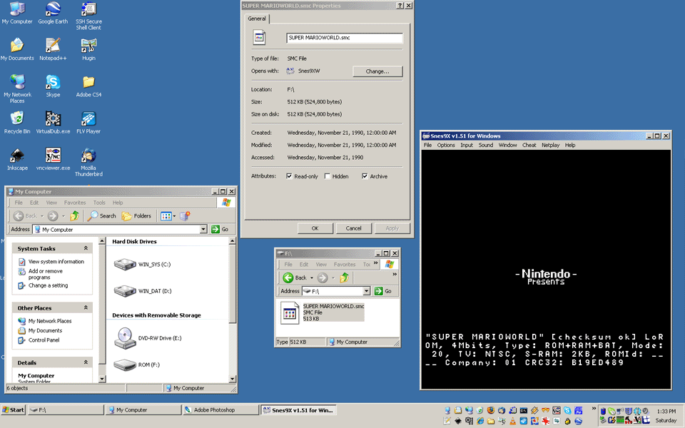

Well, here's a first success: I got the dev kit this morning, and after a few hours of fiddling with soft- and hardware, I have now a USB device that appears to the operating system as read-only Mass Storage, hallucinating a FAT16 file system with the skeleton of a SNES ROM file. Now, all that remains to do is to hook up a real cartridge and to pipe the ROM data through the USB.... Does anyone happen to have a cartridge of your least favorite game which you would donate for this noble cause? :-)

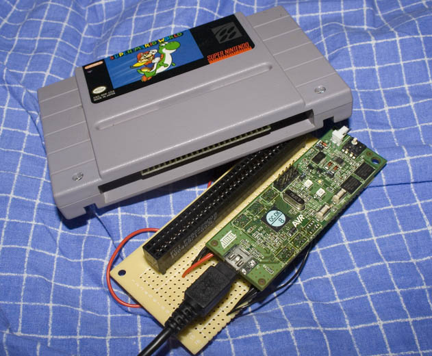

Regardless of the general public's indifference with respect to this issue, I hereby announce (to the best of my knowledge) the first-ever USB reader for Super Nintendo/Famicom cartridges! Instead of downloading pirated r0mz from Russian w4rez/pr0n sites, you can now show the world how cool you are by plugging real game cartridges into your laptop/smartphone/Pandora :-) Both hardware and software need a lot more work, but the most important game of all (SMW) is already playable straight from the cartridge...
Parts: about US$ 20 from Digi-Key. (actually, I got a development kit which was a bit more expensive but also has a lot of useless crap on it)

This might as well be an ordinary thumb drive, but it's not :)

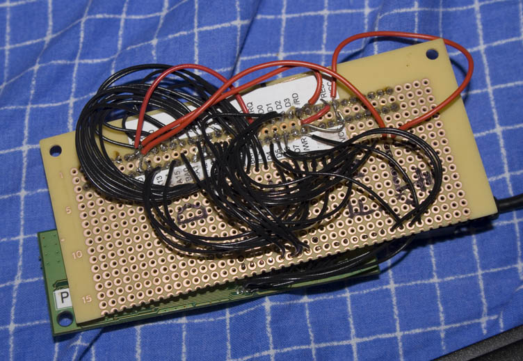

The hardware is simply an AT90USBKey evaluation board by Atmel....
.... hooked to a card edge connector with a whole bunch of wires.
The firmware is built upon the USB Mass Storage example application provided by Atmel, adding the ROM I/O as well as a "virtual" FAT16 (and don't forget the LONG filename taken straight from the cart's name field :-))
