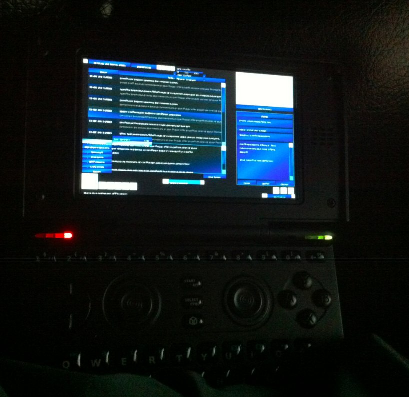

we still have some game-breaking graphical bugs :p I'll link a beta and start a beta thread when it's playable.

hoping to have a beta release with totally fixed rendering before I sleep tonight.

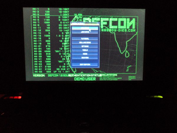

video coming, then beta pnd :) it runs quite well, will just need a few interface tweaks. I'd also recommend using the stylus.
