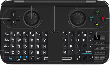

The keyboard is riddled with obvious problems, I kind of wonder if it was influenced by another device that was never meant for this size or form factor.
It is similar to this one:
But they added more keys instead of the touchpad and have one row less.
I can imagine the size of the device and therefore the keyboard is based on the PCB design.

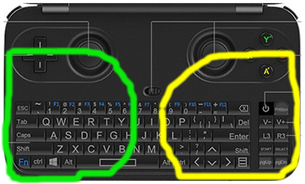

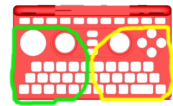

When they initially indicated the size a while ago, I mocked up a cutout based on their layout and size. It wasn't an issue what so ever . All the game controls are in easy reach as are the centre keyboard keys. Each side is 7mm wider, it's not a problem . GPD also showed this on their Chinese forum to their users using their 3D render of the WIN
The only real issue with the KB is the keys are heavily left justified and a bit small, around 7.5mm x 7.3mm. To try to compensate, they have made them domed. Although that doesn't fix the left justification
Some of us on the Dingoonity forum , including myself , provided alternative layouts . Primarily to fix the left justification and key size by moving the right column of keys thus enabling the keyboard to expand into that space. We also strongly wanted L3&R3 to be near the sticks. But unfortunately they didn't change the layout. That said, GPD have now said they recognise the issues we pointed out and will try and address them if they can.
The keyboard being off to the left is one of my biggest concerns from a usability point of view. That, and disabling stuff when switching to mouse mode seem like very poor choice to me, however I am not the one with a bunch of fairly successful gaming handhelds. The same with gaming controls since ED mentioned them. I am pretty sure they will test things at some point, and if not there is always a gaming palmtop designed from the user's perspective. :)

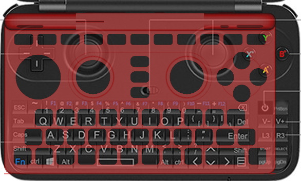

Okay, here is the concern I've got with the keyboard / controls of the GPD:
First, here is a size comparison of the Pandora and the GPD Win (according to the Indiegogo specs):
I placed the left edge of the Pandora to the left rounded edge of the GPD, as that is where you hold the device in your hand.
You can clearly see how much further away from the bottom the DPad / Buttons and nubs are.
And seeing the width of the device, you can also see that the middle buttons will probably be harder to reach.
Then I took a Pandora in my hand and tested where my thumbs can reach comfortably.
With comfortably I mean: Holding the device in the palm of my hands, without stretching my fingers too much.
If you got your own Pandora, you can check this for yourself. The buttons and DPad are easily reachable for me, for the middle buttons, and the top keys I actually need to lift my palms a bit otherwise I can't easily reach them.
I think I've got pretty normal thumbs, not very long but also not very short. Probably average.
Now, translating that onto the GPD Win would be like this:
Again, I've taken the rounded edges of the device into account.
I think 7, I, J and M will be a bit uncomfy to reach.

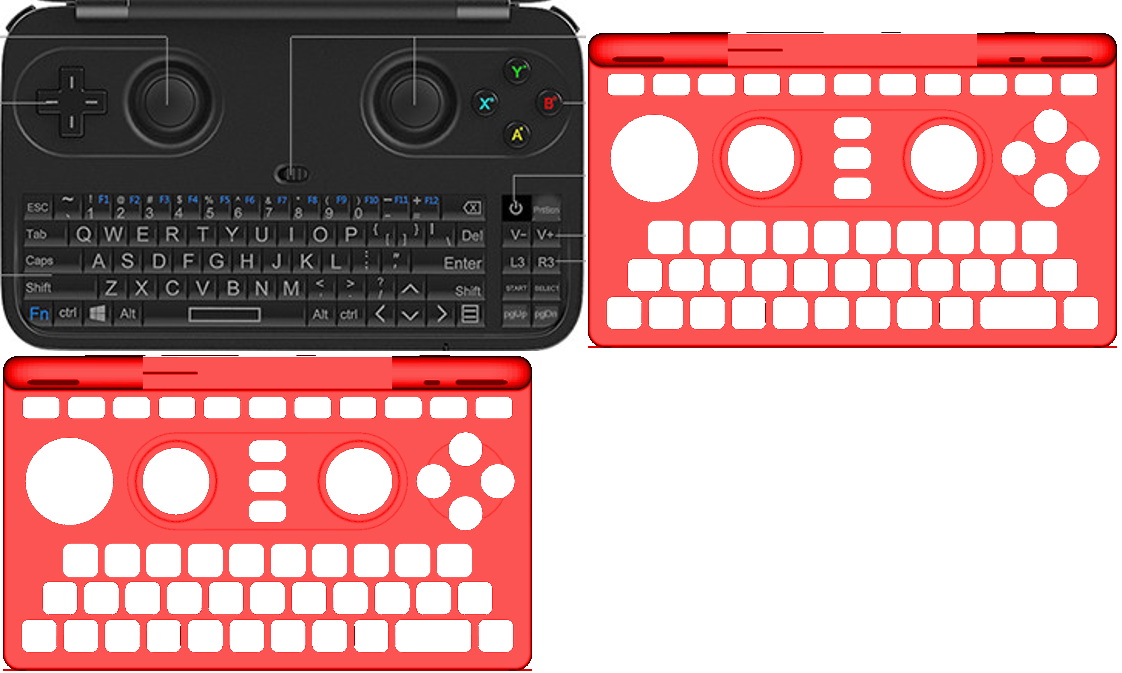

Here is a last comparison picture:
I'm sure you're right, but would you mind to compare the GPD WIN's case with the Pyra's one?
Sure, can do that later, though the location of the buttons, DPad and nub has not been changed, so I don't expect a huge difference.
If someone already printed it out and tested it, it's fine. It's just one of my concerns - I used a ruler and Pandora case and tried whether I could reach the buttons easily and it didn't work for me.
Might still be different with a real print out though.

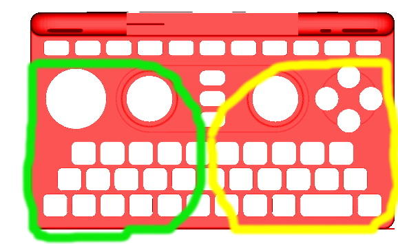

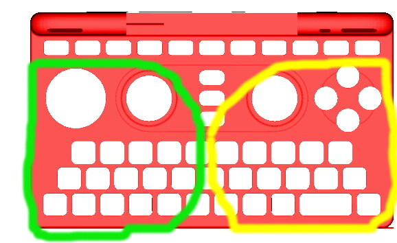

I see room in the keyboard area to have the mentioned gap in the middle, for example, key pattern could be regular like in your example pic so the separator in the middle would be straight. TAB, CAP; SHIFT, etc. buttons could be smaller so the other keys could be put more to the outside.
Something like this for example (quick edit):
P.S.: Don't forget, they have already made mockups of the case and asian people may have smaller hands than we have here (no clichee thinking intended) so if they can use the device comfortably, we should be able to do so too. ;)
