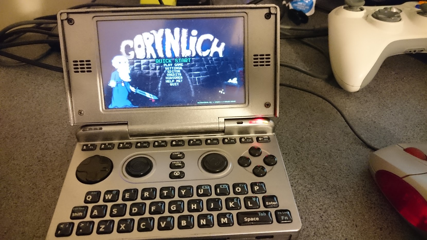

Welcome here !
Here a picture of the Pandora with Gorynlich launched.
The things I had to adapt to make it run on the Pandora (that is ARM/GLES1 based);
 * Removed the "RAM Disk" mecanism, the ARM linker doesn't like it
 * Downscale the sprites.tga texture (GLES Hardware on the Pandora doesn't support texture size > 2048)
Also, the building of a level is quite memory intensive (but that can be solved with a swapfile).
The game can be a little bit slow on the Pandora, but fun to play. Keep on the good work!
