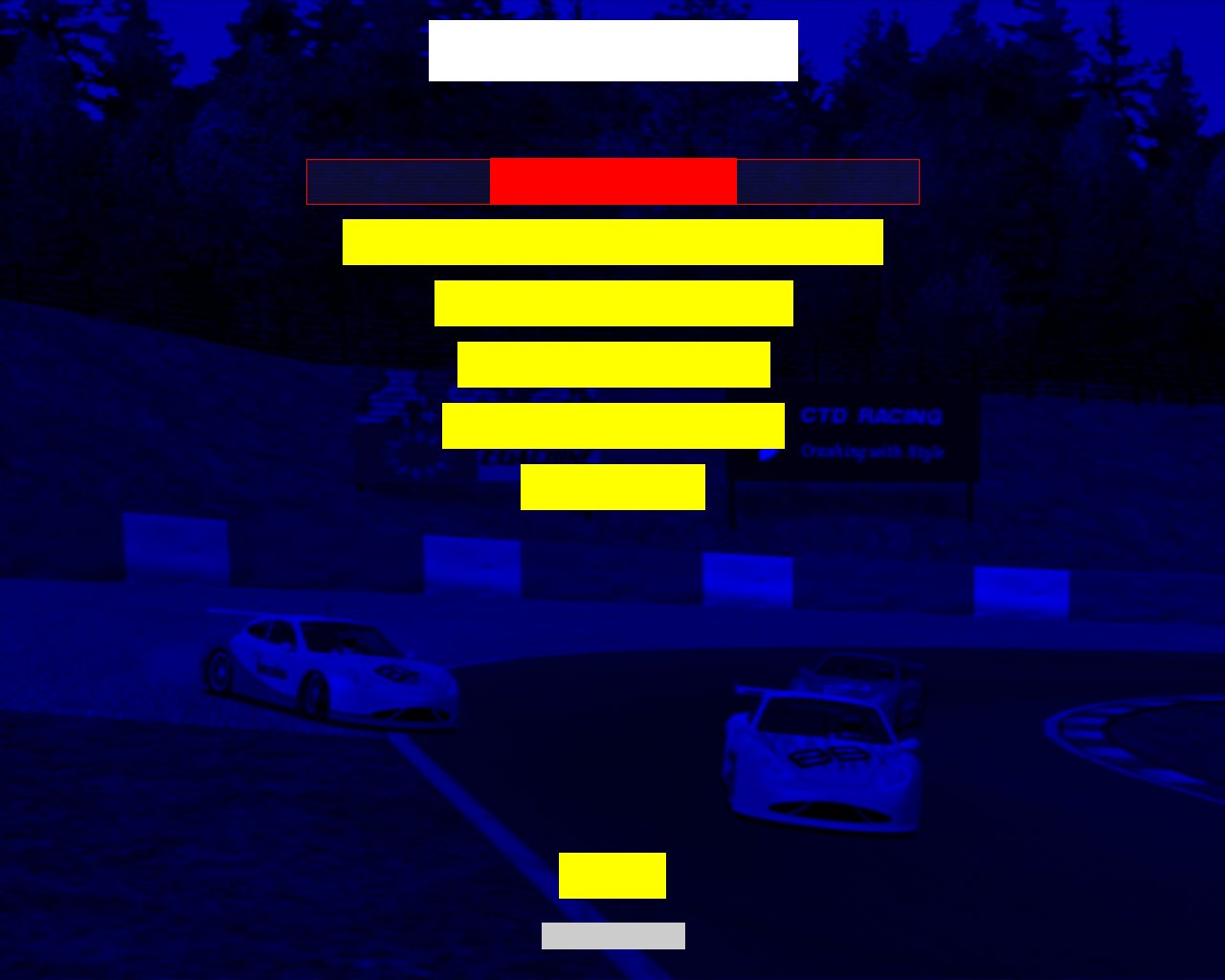

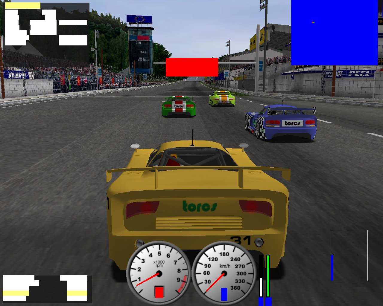

Hi,
I've managed to build and run torcs 1.3.6 on my Odroid C1 using the latest glshim.
The game seems to run but there's a problem with all text fields missing (menus unusable) and a few other artifacts. Have a look at the screenshots.
After switching to mesa and back again it's possible to change the configuration and actually use the menus blindfolded but it's far from perfect :)
I'm still using the 'debug' build with all the printf's enabled so lots of console messages are available in case you needed them.
I will first try to reproduce on my side, and if I do, I'll do a PVR Capture to check what is happening (with the capture, I have a GUI showing me all individual GLE command, GLEs states, and so on, very handy for debugging that kind of things).
If I cannot reproduce, I'll ask you the logs.
Nice tools! :)  BTW, foobillardplus seems to be the other affected program (from about a dozen I've checked over the last few days)
EDIT: I've learnt a new word - swizzle :)
And so is foobillard (non ++).
I have seen some interesting error:
libGL swizzle error: (GL_LUMINANCE, GL_UNSIGNED_BYTE -> 0x2002, GL_UNSIGNED_BYTE)
libGL: unsupported pixel format 2002
libGL: unknown pixel format 8194
So, probably the source of the issue :)
yep.
I tried to make some things with the internalFormat of the texture... I have change the strategy, it should be better now (commit pushed). At least foobillard is ok now.
yep.
Apart from the mini map in torcs everything's back to normal. It used to work, right?
I did update libstdc++ a few days ago and as I have never seen this message before:
refresh: ssgCullAndDraw invalid enumerantor
grDrawBackground: ssgCullAndDraw invalid enumerant
I'm not sure if it's torcs specific or the update broke something.
@petevine, yes, I have done a few changes here and there. Mostly for speed, but not only.I have hacked FBO support for offscreen rendering of the mirror and map, and hacked a bit the map rendering. The problem is that the "glutGet(GLUT_WINDOW_ALPHA_SIZE) " function, called in src/modules/graphic/ssggraph/grtrackmap.cpp will probably not give a relevent result. So I have changed
