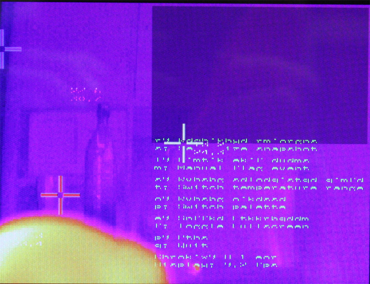

Hi,
so i'm using glshim in different versions on an raspberry pi 2 with an fresh installed Jessie Image.
First i try the unstable Version from lunixbochs and have some issues you can see here:
https://github.com/lunixbochs/glshim/issues/146
Only the last few post interesting. I use an thermografic cam with the raspberry and want to render the image with the Text on it. The IR-CAM App is using freeglut and with software renderer ist extremly slow on fullscreen.
Text something like the temperature of some points etc. is not show correctly.
The only branch that works is the "actuallly working on it" lunixbochs unstable version i have cloned with git. In this i can use fullscreen with good performance.. but the text is not readable.
See the image here:
BTW:
VC4 is not an option, because have no composite video out support, and i want to use both... HDMI and on other time Video Out.
So yesterday evening i had test the ptitSeb Version but fails in some missing calls like this:
undefined Symbol:
gl11_client_state_init
Have somebody some ideas?
