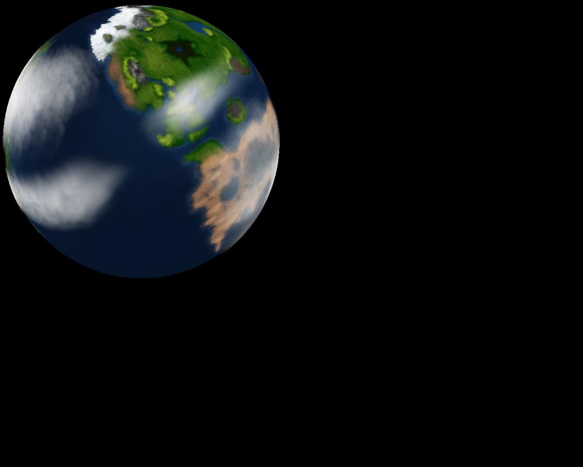

The issues mentioned in your repo wiki are gone (or not applicable on Odroid) but all's not sweet. I've managed to find a serious glitch visible in the attached screenshot (all 2d elements are gone). I'm attaching the save in case you wanted to have a look at what the level's supposed to look like on x86 (should go into .t-engine/4.0/tome/save).

I am not the owner of this port, and I must confess I never tried this game, so I don't know. I'll try to make a compile to work on glitch you found.

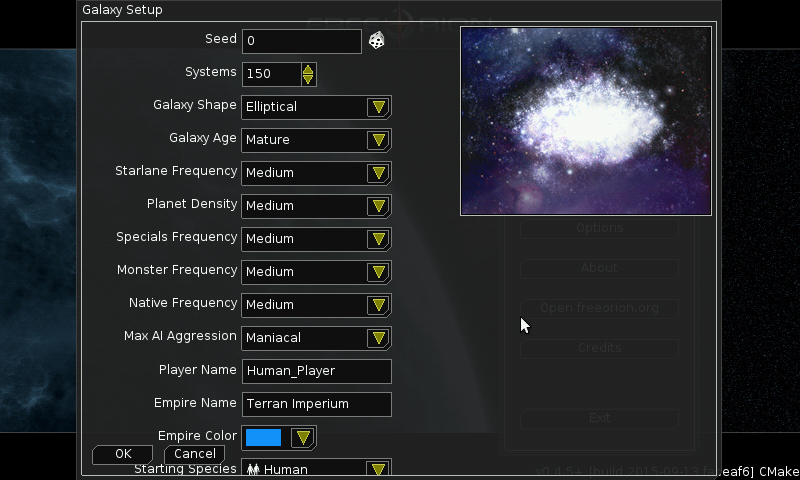

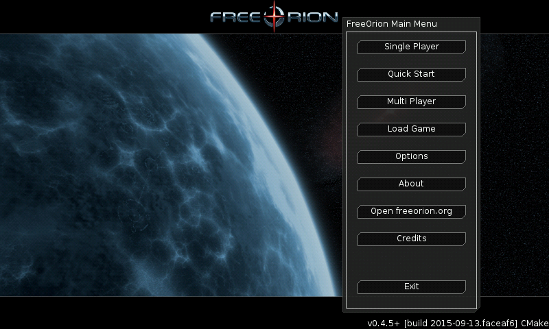

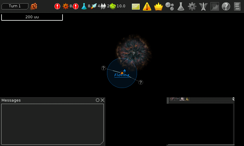

So, I finally got FreeOrion to run on the Pandora.
This one is a beast to compile! Really.
I succeed to barely compile natively, but memory issue and compiling time is huge (4Go swap, and sometime it get killed, and days to compile).
So, I reluctantly built a Cross-compile environment, higly experimental, using codeblocks.pnd as base for all arm libs and a Linux Mint x64 VM.. After hours of messing, compiling and patching binutils & GCC, I finaly got something. Once transfered to the Pandora, it works! Yeepi.
Now, The game seems a bit slow (it needs lot of memory and CPU power it seems), and there seems to be missing thing using glshim as reported. I have now to try fix that.

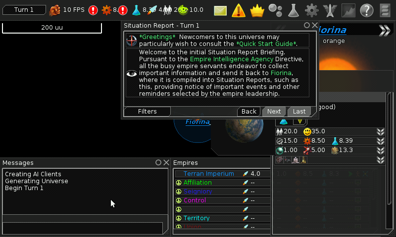

You mean (judging by that last screenshot) all problems are gone? The research screen as well?
Well done, I think I might donate!
Yes, I think I have fixed all the rendering issue. I pushed my changes to the github repo, so it's ready to try.

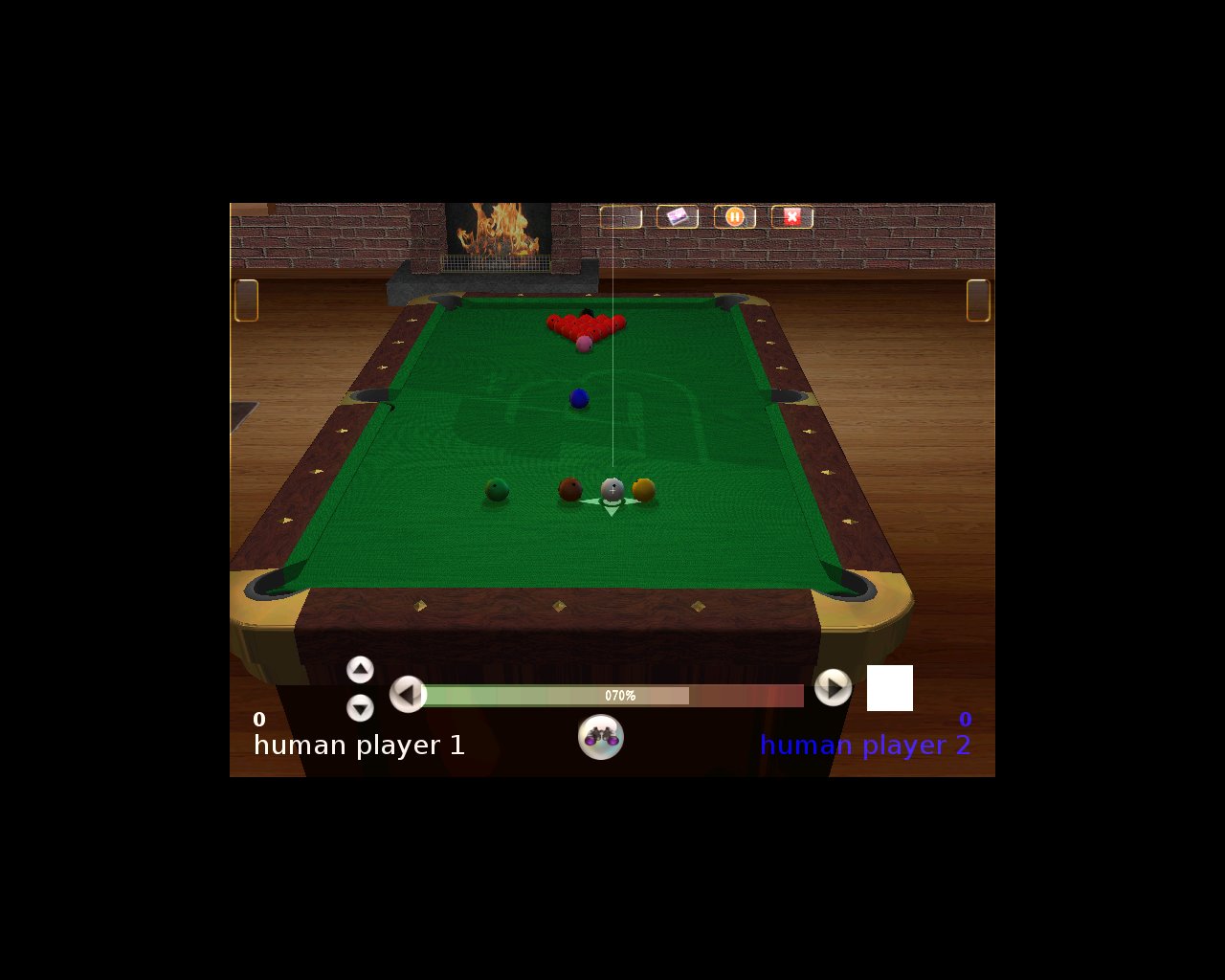

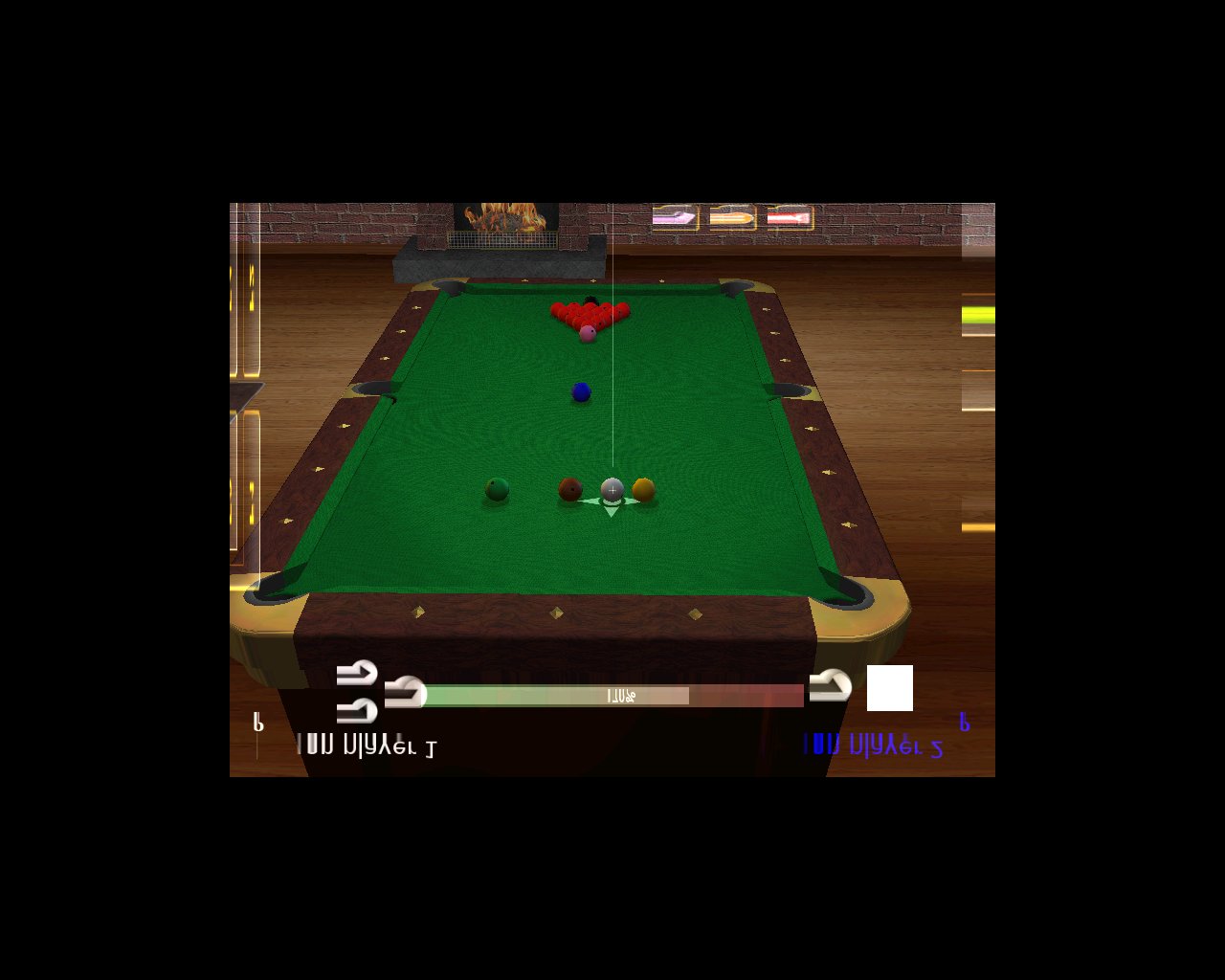

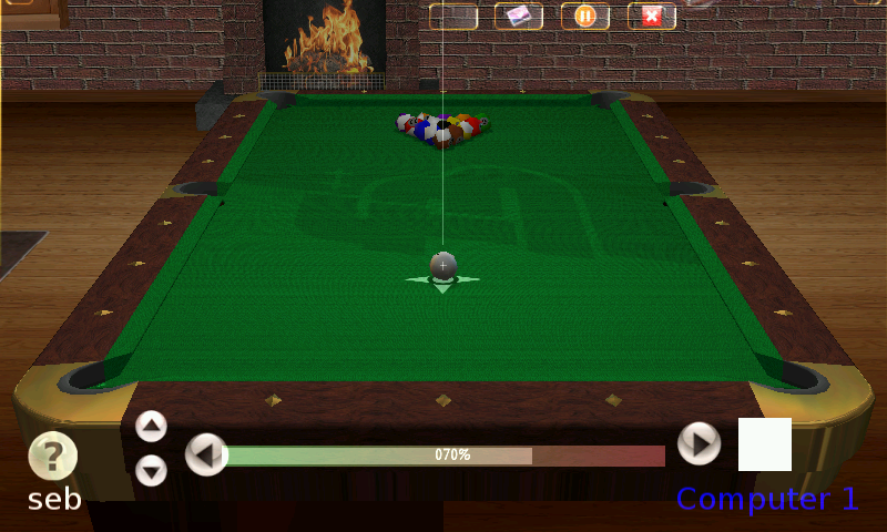

Now, the glshim itself has experienced a regression, noticable in foobillardplus (see attachments, after and before)
BTW, the forum link on your github homepage is broken (recent changes here?)
FoobillardPlus was running? Last time I tried it was not working well for me (worse than the broken screenshot). I'm surprised, the regression came with just my last commit for FO?
On my Odroid C1? Yes and yes.
