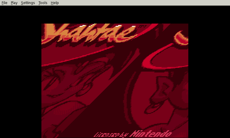

First, you have to CTRL-F to go partialy (that is with aspect ratio).
Second, I prefer full screen and it defaults to keep aspect ratio, which displays 'slanted'. If I switch to my prefered no aspect ratio it goes full screen and isn't slanted.
Third, sound should be adjusted from default as well to use oss instead of alsa.
Finally, it doesn't create appdata folder and no settings are saved.
It appears that gambatte should be writing a file to ~/.config/gambatte/gambatte_qt.conf. Ill see if i can fix that tomorrow. The stretched screen can be fixed temporarily by changing to not keeping the aspect ratio. Once the config file is fixed it should fix quite a few of those issues.

First I was refering to CTRL-F (is hot-key) to put in fullscreen mode and second was refering to the following.
For that issue change scaling to integer only or none. Zip files will work in the next update. I am trying to fix the config file saving to ~/.config/gambatte/gambatte_qt.conf instead of ./gambatte_qt.conf

Vsync can be enabled by changing vsync = false to vsync = true in pandora/appdata/gambatte-qt/gambatte/gambatte_qt.conf vsync doesnt actually seem to work :/
To enable complete full screen, press Ctrl+F and Ctrl+Esc.
To fix the x11 slant issue, as I
said before just change the Scaling Restrictions to None or Only scale by integer factors.

also weird thing happened, once I changed the render and went into full screen CTRL + F I lost my ability to enter menu, exit out of full screen, or even close the app, not even holding down pandora button or fn + pandora worked, had to hard boot the device.
not sure if it's possible but a true fullscreen without the menu bar at the top would be good. Does this have a SDL or as ED mentions a way to throw the app comand line switches or variables for use with a different front end like pickle launcher? Also if there is ability to set hotkeys for save and load state S & L , 1-0 for save slots, f for fullscreen {intead of ctrl +f) stuff like that.

Android and others: Press ctrl-f for fullscreen, and ctrl-ESC to get rid of menu bar. There are hotkeys for saving savestates, and they are even redefinable. Look in the settings menu.

Sadly, vsync is not an option for X11, only for glpointer.
It's a bit improved when using 60fps, but not perfect.
It doesn't support SDL Output, right? Otherwise we could use notaz scaler.

FYI, It does support starting in fullscreen with -f and files on commandline. I just finished incorporating picklelauncher modified from snes9x pnd. along with my prefered conf file.
