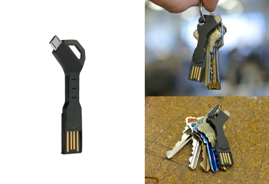

Something like
should be included for reasons you mentioned.
You put that inside the hardened case, or, you put it on your keychain, and use it for all your devices. Or your friends devices.
This is actually kinda cool, and I sorta like that idea.  I don't recall seeing these before.
