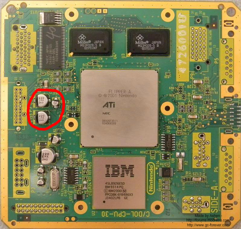

It definitely sounds like a capacitor is on the way out. If you are handy with a soldering iron at all, there are a group of 8 or so capacitors bunched up around the two AV outputs. I can't remember which ones do what, but seeing as there are only a few there, it might be worth your while just replacing them one at a time and seeing if your image improves. You could also try the second AV output on the back of the Gamecube. The ports are slightly different, so you would need to have the appropriate cable.

A little research told me which capacitors do what.
the capacitor to the upper left it for Composite video, the other two in the circle is for S-video.
Edit: I should also mention the orientation of the board in that picture, the memory card slots are to the right, and the AV ports to the left
That's the one. Nice find :) I remembered that there are only 8ish caps at the back of the board, but couldn't remember who does what without the picture...
Those are SMD capacitors, which means you might need to find someone with a hot-air station to replace them.
On the other hand, I have heard of people doing it with two soldering irons and three hands (you heat the two legs and have someone else wield the tweezers).
Good luck.
well since there's only two legs, one could just heat and lift up one side, then do the same for the other.
Possibly, but I've read that there is a fair chance of pulling the traces off the board by doing it this way.
