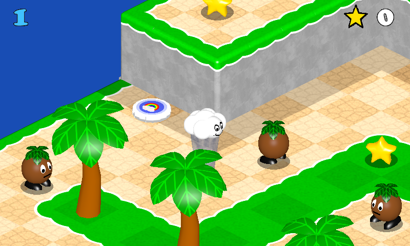

ok here the Video from my short Test :)

[doublepost=1471992650,1471986984][/doublepost]@Steinbock
I modified your PND with updated Libs from our Codeblocks.
Now we have not many Errors more and its faster than the first Video.

And the new Video:
and the newer PNDis in the Attachments :D

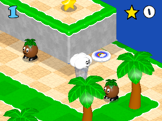

Hi all,
I finally gave @ingoreis ' version a go today :)
The game is currently extremely slow (even with OC @ 825 MHz), and fails to start on my Rebirth with SGX driver 4.10 (it works with 4.03.00.02 though).
@ingoreis : regarding SDL error messages, did you give @notaz ' improved version a try ?
EDIT: OK, I did try it, but couln't notice any improvement. I also tried things like LIBGL_FB=1 and LIBGL_BATCH=1, but to no avail...
EDIT 2: I don't think the CPU is the bottleneck (~half idle @825 MHz), so the SGX is the issue here IMHO. @Steinbock : any idea how to ease the load on it ?
@Steinbock : could this link be of any help to you ?
Anyway, I think it's a good start ! Please keep up the good work :)

@Magic Sam
Thank you for your investigations.
About Pandora I really don't know anything. Even not how to make a correct PND :)
Tonight i make some tests with the code on WIZ. Somehow i feel like bottleneck is more related with acces to dimensional arrays or something like this.
When i disable most draw-commands, there is nearly no difference, so GFX should not be the problem.
The graphic error with Cloud-Sprite is also something what could be solved somehow:).
