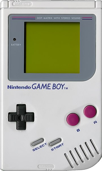

I expect that this will be the standard example of durability, nothing less for the Pyra:
I think a device that can be put to use will get more use. Durability always wins.
