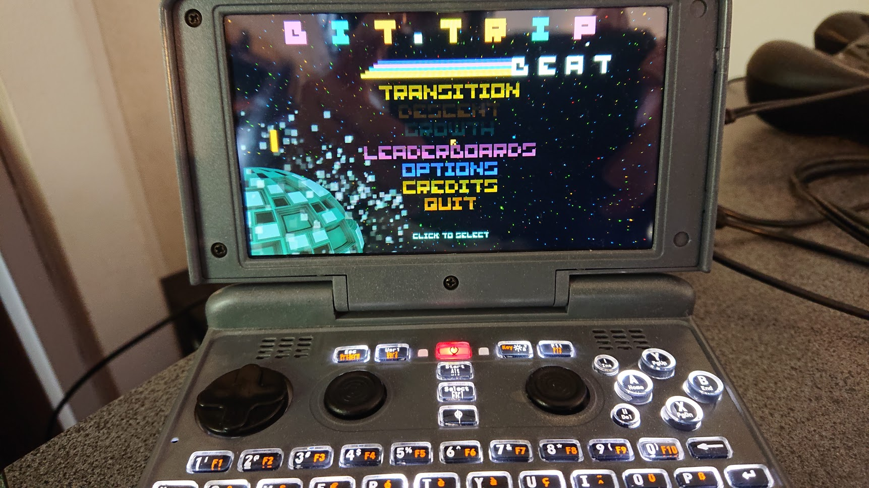

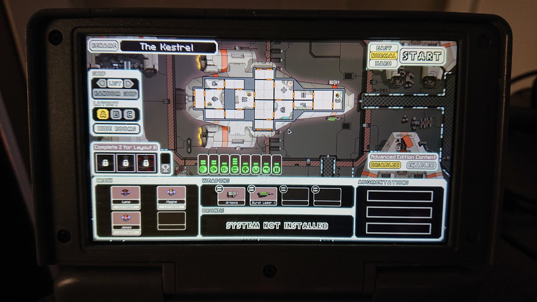

So @daveshah as made a patch to make 3D Driver compatible with @zmatt Tiler code. It's a bit manual for now, but will improve quickly and @aTc is planning to integrates all this in the firmware.
And it works
Only picture, so you don't know if it's smooth...
But yeah, my short session on Bit.Trip.Beat was smooth and nice (playing with the nubs...).

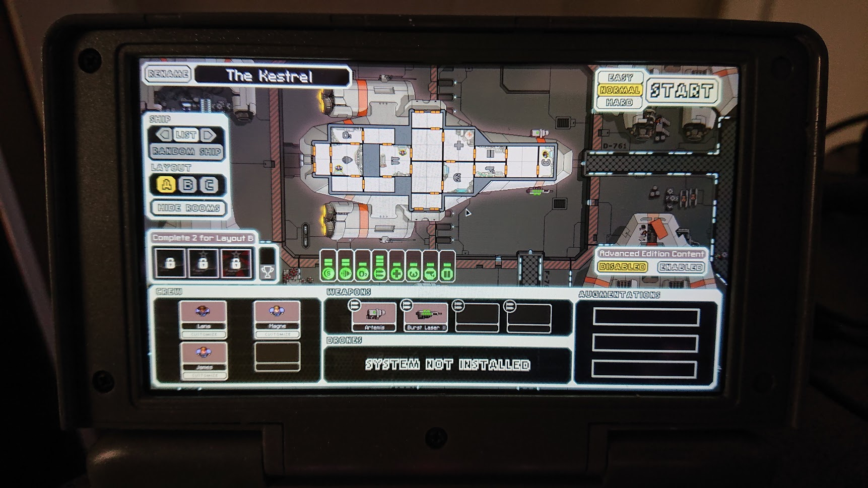

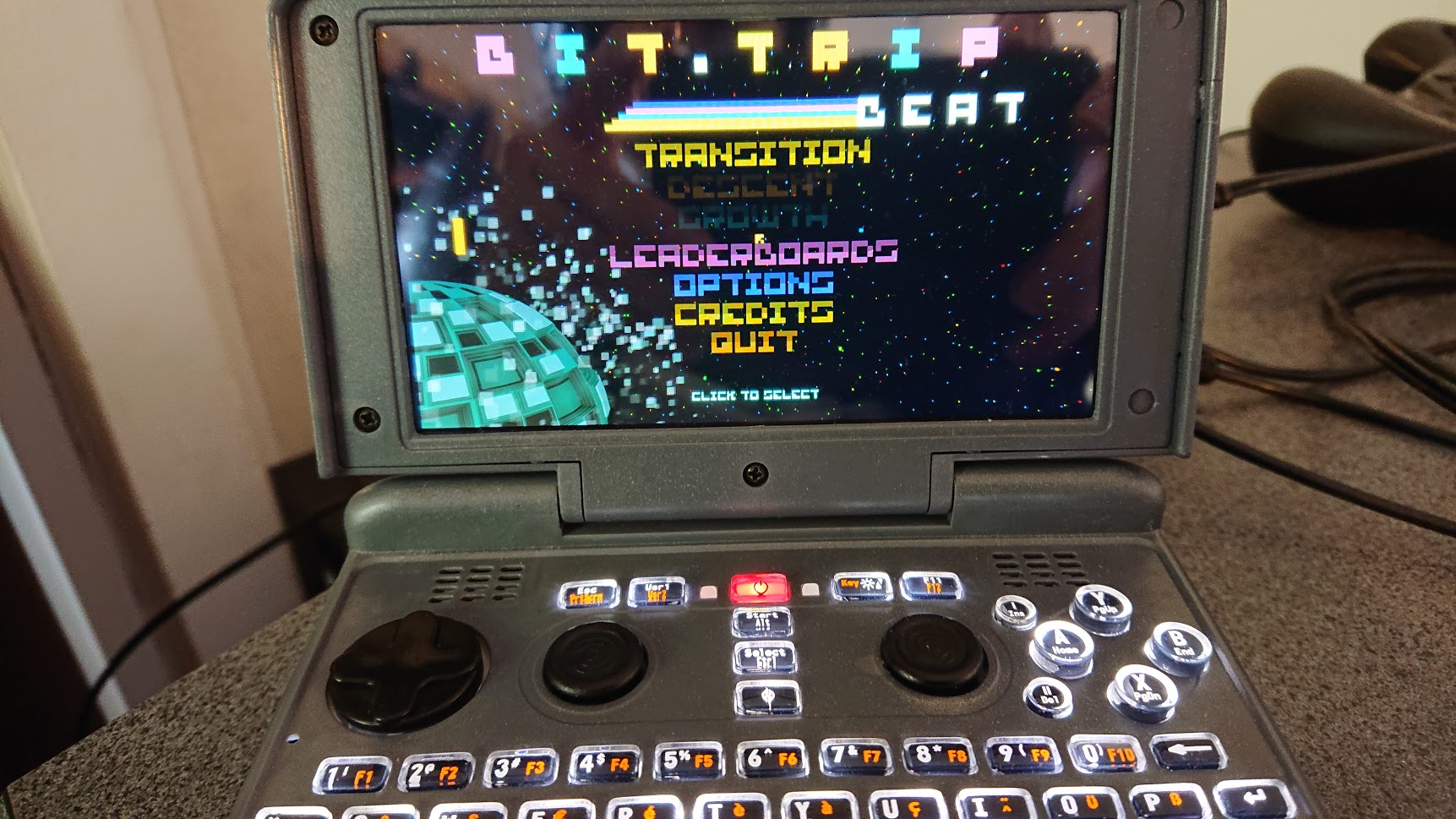

And it works
