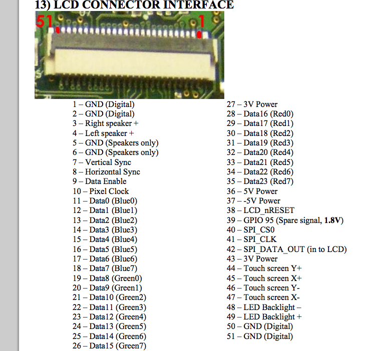

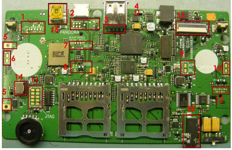

Link did you re-seat the lcd connector to the main board when he sent it to you (13 in the pic below)? I have a feeling there is dirt/dust in the main connect for the lcd ribbon cable and that might be fouling up the connection?
Maybe try blasting it with air and re seating the lcd cable

To clarify, re-seating means just pulling it out, air-blasting, and pushing it back in, right?
Thanks for the hint, Gotwake.
I found the video about the screen really intimidating. Opening up the case seems less so (no messing with the antenna).
I will give it a try.
Yes it does.
You only have to open the bottom portion of the pandora to re-seat it ( should be like 4 screws, make sure you don't over tighten them when you put everything back together)
