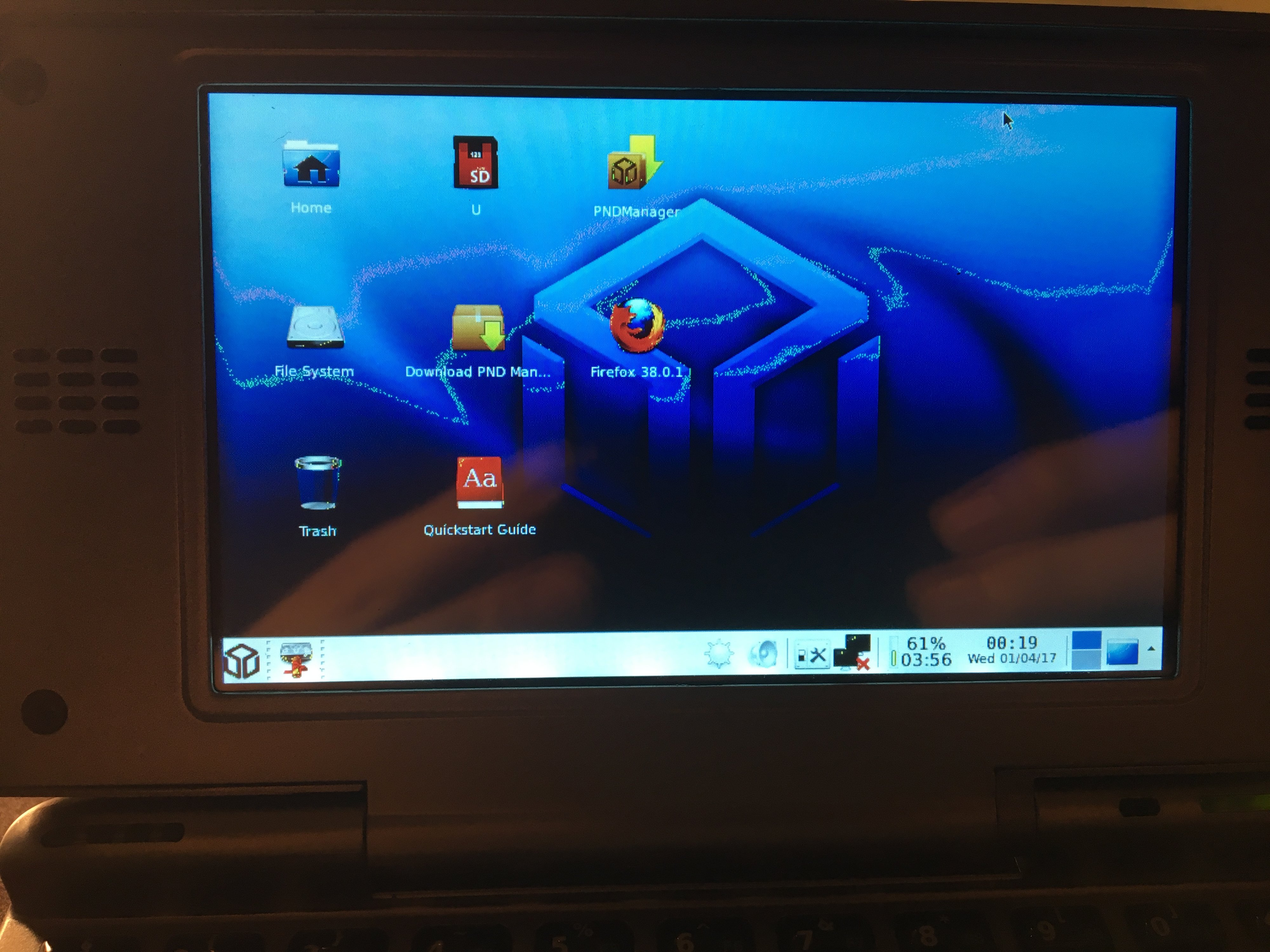

Hi everyone.
I made a post on the Pyra forums area about the Pandora problems. Because I preordered a pyra to replace my pandora, but seems I still need to wait. So I want to solve my pandora's problem and stay with it for a while.
Here are the problems:
The touch screen does not work anymore but the nub still works fine.
The screen looks wired some lines and the color looks wired too.
The central part of the PCB is warm on the key board area between the two nubs.
Thank you all. And here is the picture of
screen.
Maybe open it up to check to see if the LCD cable is fully inserted? :)
Hello
I just replaced an new LCD cable and checked it several times. Maybe somewhere fried? I saw a post like this before.
Thanks for your reply.
Sent from my Nexus 7 using Tapatalk
on the warm spot of the pcb,
i think it's normal as the soc-chip is placed in about that location.
all the best for solving the screen problem too!
Thank you so much. I am trying to fix this pandora while waiting for the Pyra. Hope Pyra will come soon, so I can replace it.
