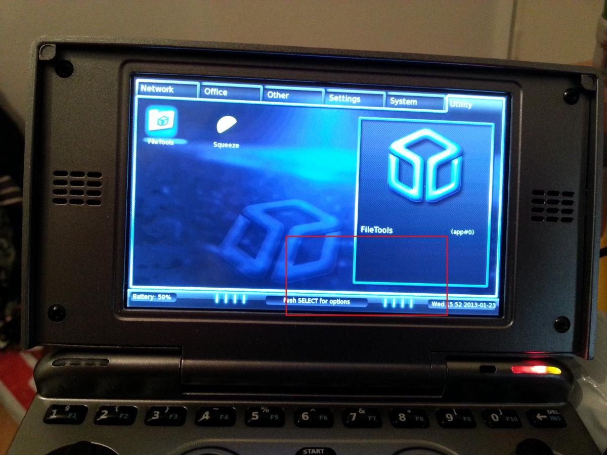

Right. I've got my 1Ghz Pandora today. Everything is running flawless except for one thing:
The touchscreen is sensing the input wrong at a certain area of the screen.
If I put the stylus anywhere there one of three things happens
1. I'tll think I've touched the screen on a different place, If I move the stylus in that area it will move the pointer in the opposite direction (mirroring it)
2. It will move the pointer to the far left side of the screen, same y-coordinates.
3. It will spasm around until it has finally found the right spot, however it will still spaz around a bit even if I keep the stylus on the exact same spot all the time

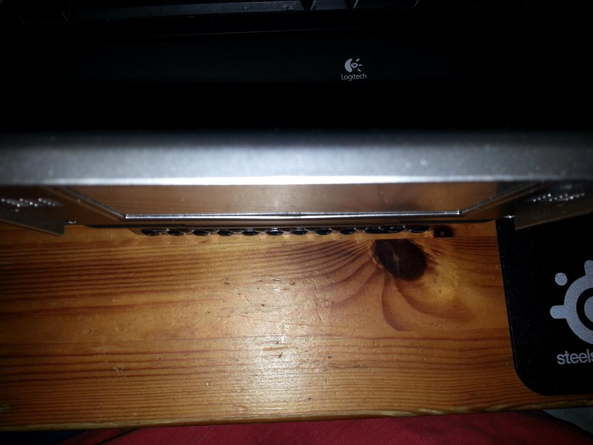

Edit: I've just noticed that it's working perfectly as long as I press down on a certain part of the casing right beneath the area. As soon as I release the pressure it's acting up again.
Edit edit: There's a very noticeable gap exactly where I have to press it down for it to work.
I've tried taking a picture. You can actually see it fairly easily.
That gap is there on most units. There might be some dirt inside of it or to the left or right under the bezel.
You might try hitting it with a blast of pressurized air around the top of the LCD screen where the bezel snaps in. Have your Pandy powered off when you try this.
This was a suggestion given me by Link when I was having trouble with my touchscreen and nubs not working right...it DID fix the nub problem, but not the touchscreen, so, in my case, I maybe have a broken lcd cable...Link will sort that out, my Pandy should be in his hands today.
BUT, if you DO have some small dirt or something under the bezel and you just don't see it, the air might dislodge it.
But use actual pressurized air from a can like they sell in computer/electronics shops...not a big whiff of your own breath, since that could also put saliva and stuff in there, you just want a good, clean burst of air. It might help, and no harm in trying it.
