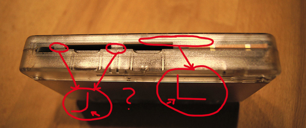

Analyzing the Pix I spot some strange thigns on the front gaps. The seam that should be flat and straight between the SD slots (where top and bottom part meet) seems to be rounded, shouldn't it be flat? And the surrounding "trench" looks very sharp, this should be actualy rounded (was a bad part of the Pandora case by the way).
So basicly, the roudned part should be flat and "sharp" and the surrounding sharp angle part should be rounded imho. ^^"
