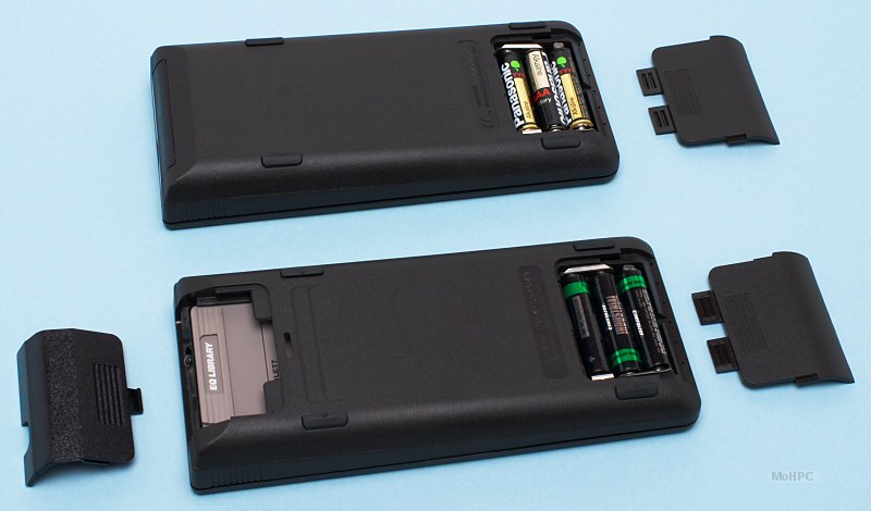

I defended a very textured surface in external plastic parts, for example like HP-48 calculators (really they were pocket computets).
In that way those optical flaws dissapear. And at the same time you have a no slippery device. I hate flat and like polished plastics as they are slippery and more prone to marks by using them.
Hmm... these calculators have very very thick plastic cases. I wonder if the textured plastic hides flaws or if the thick plastic prevents them. (Or minimises them, I should say, because both my 48SX and my 48GX have (barely noticable) flaws in the plastic. And in your lower photo isn't there a semicircular flaw spanning the middle of the back?)

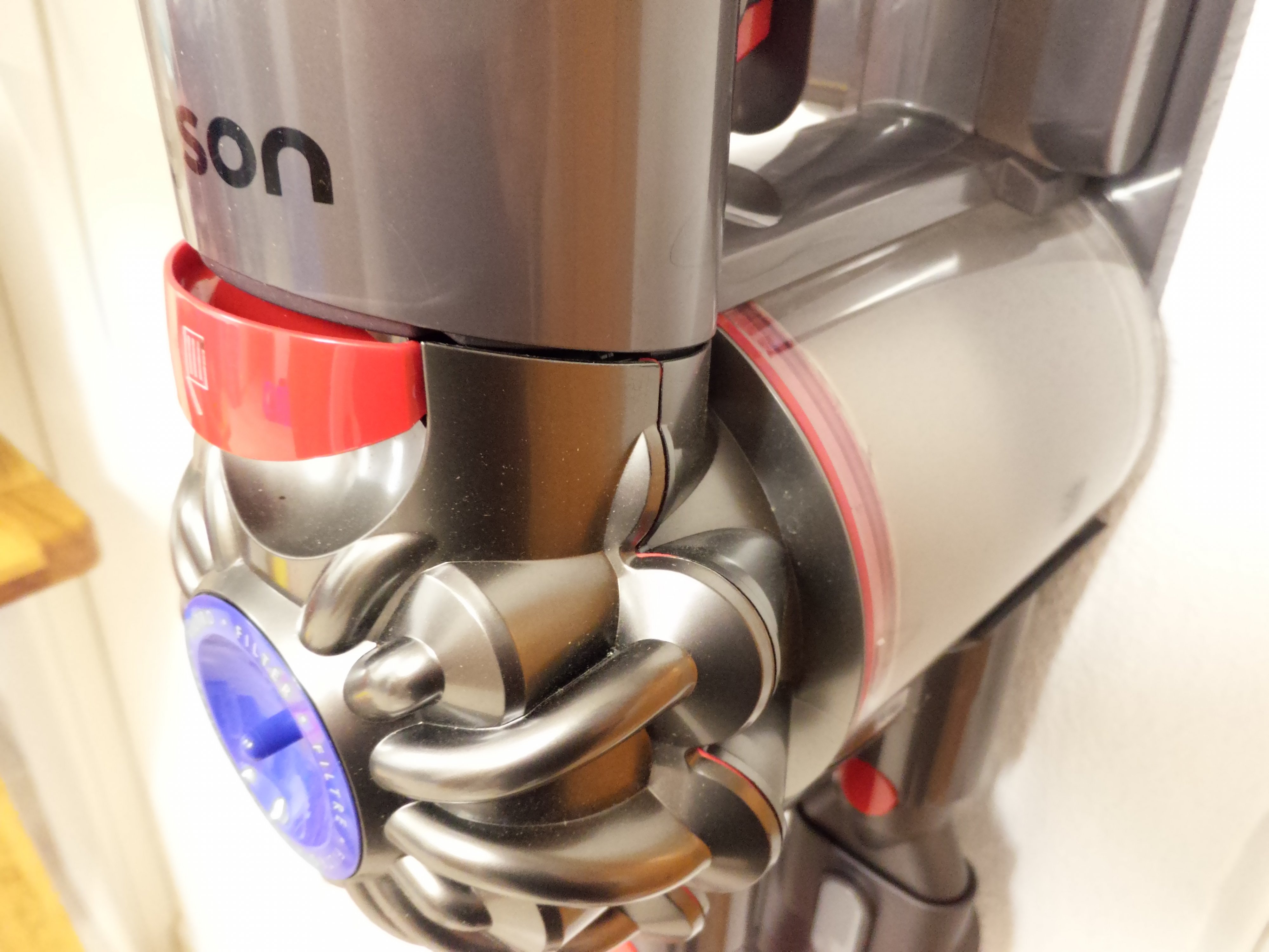

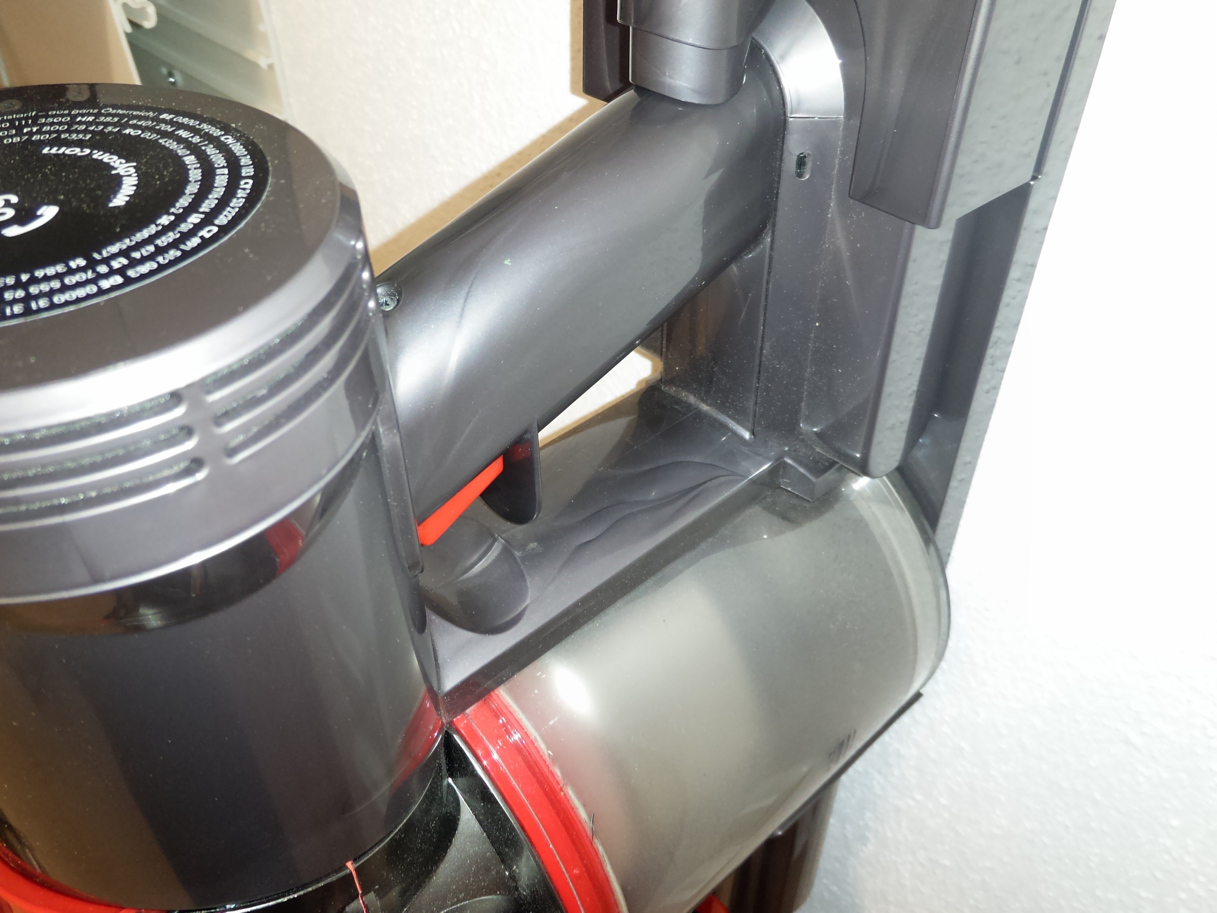

In my opinion, discolorisations are not that bad at all.
I'm rather afraid that the color of the paint won't match the plastic.
If I'm looking at a dyson vacuum, most of the parts suffer from heavy discolorisation. Only the cyclone is painted, as most probably its some kind of fiberglass material to withstand abrasion.
Nevertheless you can spot a color difference between the two parts.
Therefore I would like to avoid the color.
If color has to be, please paint the whole case, not just one part. The paint will age differently from the plastic resulting in a (maybe huge) color difference over time.
