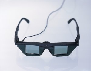

I got the wired ones like these -
They kick ass for the price :)
