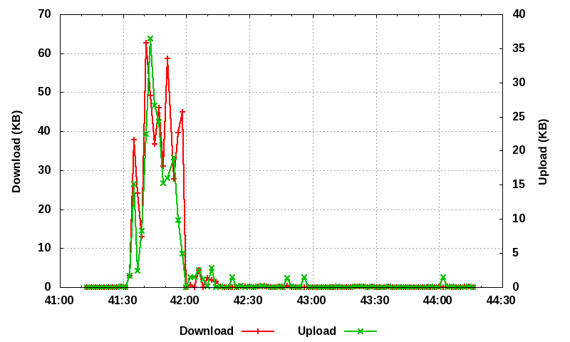

wifi-powersavingon-lucky-600kbs--1000mb-wget-from-wired-local-webserver--20121225-195034.png Then one lucky time it got 600 KB/sec.
And it kept it until my server accidentially went down. I could not recognize any logical pattern yet.

I did the wget test with power saving enabled. Several times. And one lucky time, it started with 70 KB/s, stayed there a while, then increased to 150 KB/sec, kept that speed a while, then reached about 600 KB/s, and then kept it. Permanently! Only a speed drop of 1-3sec every 30-90secs, but always returned back to about 600 KB/sec. Normal network variation.
Now it all got clear to me: If WiFi connects to a server with a stable high downlink speed and downloads a large file which thus causes a long lasting connection, and this transmission lasts long enough until reaching a certain critical point, then it reaches a stable condition with a constant proper transmission speed!
If the connections are of shorter nature (such as web browsing, where one page contains numerous small files, which are downloaded in parallel or sequence), or where the downlink speed is bad, that critical point is almost never reached, and power saving cuts in so aggressively, that it "kills of WiFi, before reaching its potential", cutting into its own flesh!

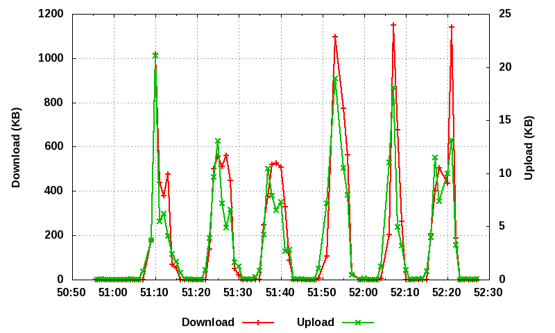

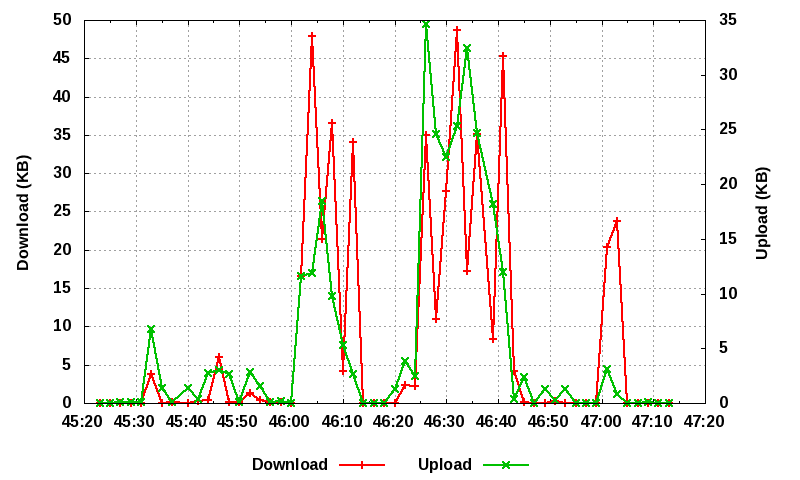

wifi-powersavingon-website-loading-never-completes--20121127-004113.png Loading never completes as WiFi croaches or stalls.
wifi-powersavingon-website-loads-complete-due-to-several-manual-reload-issueing--20121127-004523.png Only in a few moments or after several reload attempts, one gets lucky because either the page is very small or some connection luckily "made it through" the improper power saving treshhold.
PNDManager
View attachment 5041 Was practically useless. Only a few large downloads for which I triggered several reloads, once got onto the "lucky line of the WiFi power management", and then downloaded with an amazing speed.

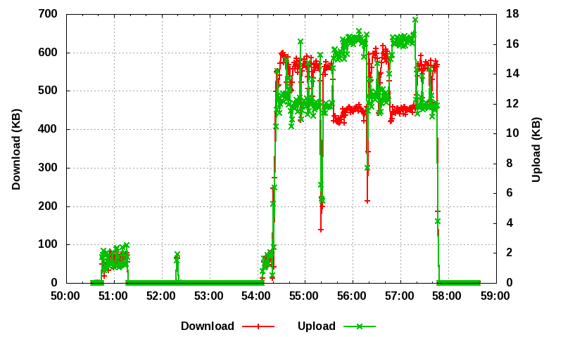

View attachment 5039 Through my research I realized that once a certain critical point of download duration and speed was reached, it then reaches a stable condition with a permanent high transmission speed. In this graph it starts with ~70 KB/sec, stays like this a while, then ~150 KB/sec for a while, then climbs to ~600 KB/sec and keeps it! Just some occasional temporal speed drops here and then, 1-3 seconds of reduced speed every 30-180secs.

No graph needed. I reach an avg of about 600 KB/sec with occasional 1-3 second drops every 30-180secs. Nice!
