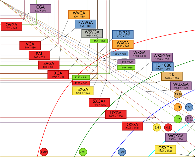

If one exists, a 1280x768 WXGA would make a good theoretical fit. It would have the pixels needed for HD720 with small black/gray bars top and bottom and be able to do 4:3 at 1024x768 having black/gray bars on the sides. I did a quick look - unfortunately I don't see anyone using a 1280x768 display in 5" +/- screen.
However, it looks like 1280x720 is in the process of becoming a multi-vendor common screen resolution. It's being used at 4.8" in the Galaxy SIII, 5" in the new Lenovo device, 4.65" on the Galaxy SII, etc... It is becoming a common resolution - which should translate to being a more common and cheaper part to buy.
If we want 4:3 out of it, 960x720 with bars should be enough pixels to play with. It divides down oddly though into 480x360 with pixel doubling - which means somewhere in there the emulator working from 640x480 source has to translate 480 pixels into 720 or, factoring 2 source dots into 3 destination pixels. 800x600 would scale weird as well.
The Galaxy Note has a 1280x800 5.3" display - which might work nicely. The drawback there is that, from what I can tell, it exists only in this one device and may not be readily available.
Are there any other displays on existing devices that have a better resolution to work from?
