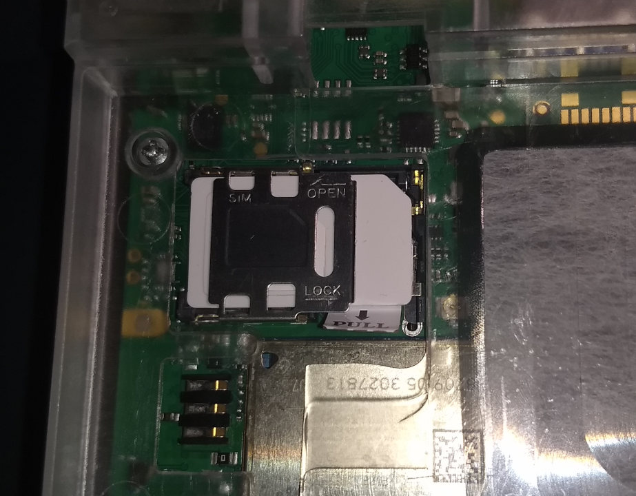

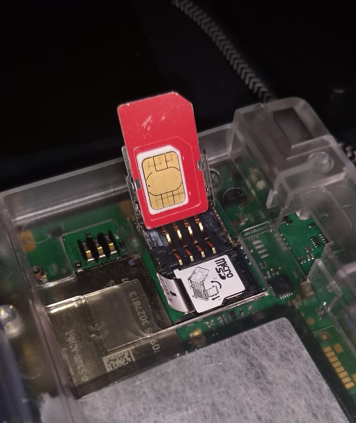

Another thing to take care of is that the sim should be inserted properly, while you can push a nano sim in there, that's not what it wants :

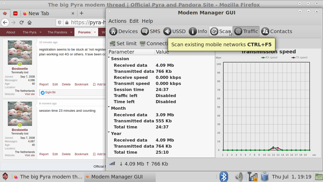

registration seems to be stuck at 'not registered' and mode at 'unknown' I also only get H but that might be not having the correct apn and stuff for this prepaid card. I only get the default plan working not 4G or others. h'ave been connected for about 1,5 km of my 7km walk now if you see somebody walking in rotterdam while typing on a pyra it is me :D
Dont trust the statistics of that tool too much. Just a second ago i had an upload of 1.02e+03 kb and my season timer is pretty much randomized. Plus a claim of having 1.6TB of total transfer with a plan that allows 1Gb per month.
Can you show whats on you info page there too?

managed to get 1 continues session while walking 4km, lost reception close to my house and didnt get it back. It is very picky when it comes to reception. Still didnt seem to get 4G but also have to check better what my prepaid card supports and what the actual settings should be. But I can confirm the modem is working.

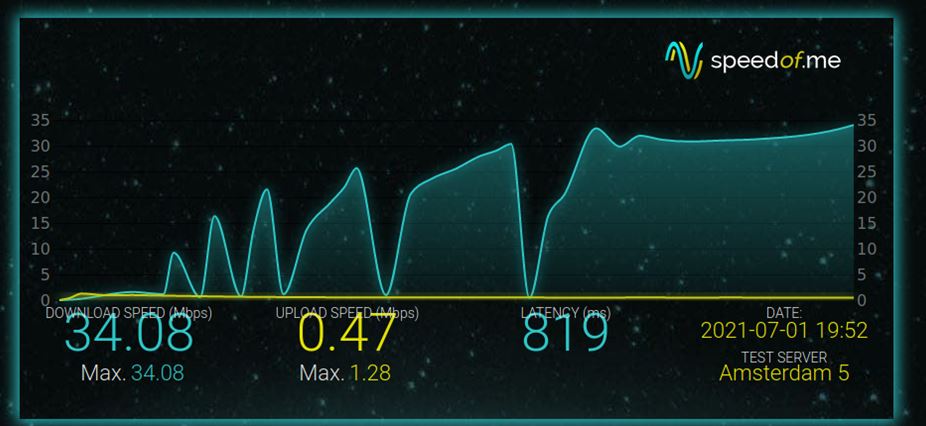

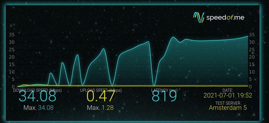

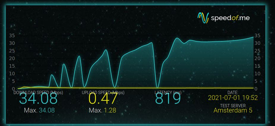

Wait you get max 1.28Mbps upload speed?! o_O
