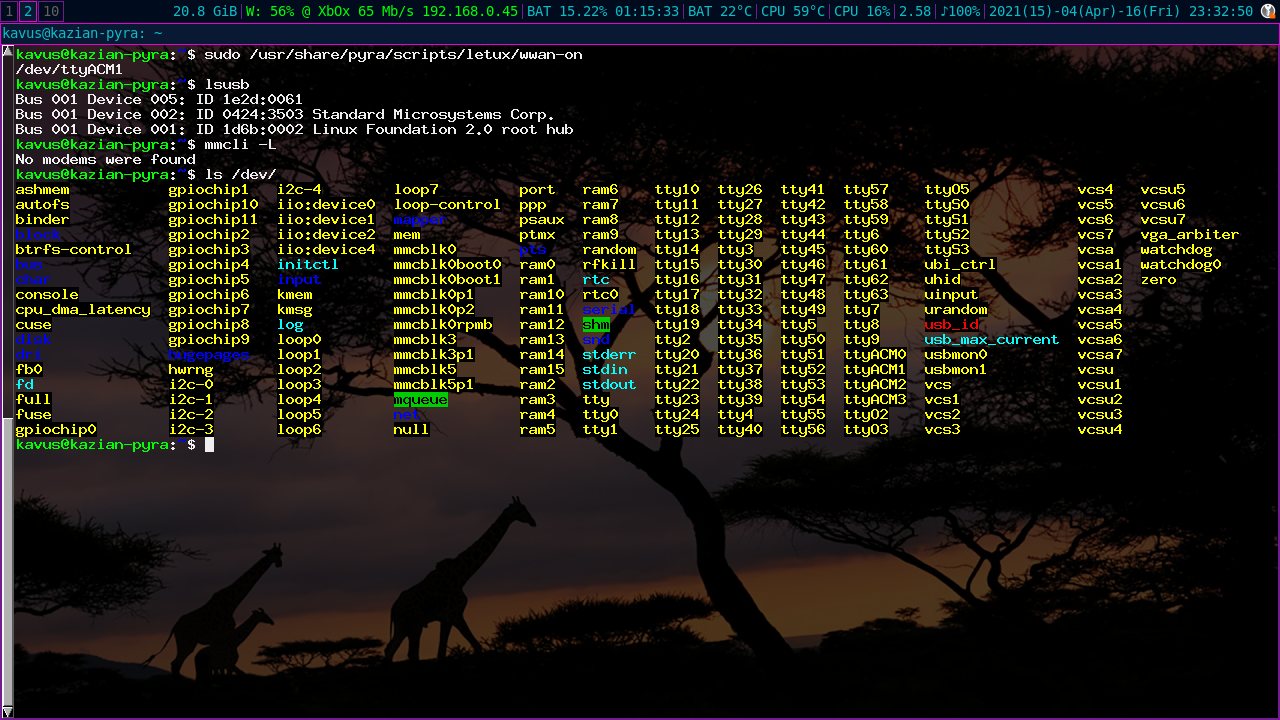

Yes, same result as when I use `sudo rfkill unblock 0`Does it come back when you run "sudo /usr/share/pyra/scripts/letux/wwan-on" ?
this looks ok to me. to my knowledge only devices listed in '/usr/share/hwdata/usb.ids' are showing names when using 'lsusb'.Also while the modem is present for the minute or so it is, the lsusb entry has no name, only pid and vid.
It never did this before, and even while it's present, modemmanager says there are no modems on the system.How where you using it before it started to disappear?

I tried to use it but there's no signal where I live. I then tried it at the grocery store and it worked. When I went to try it again at my aunt's house, it was exhibiting this issue. I have received and sent SMS from the grocery store parking lot. So I've only actually used the modem once. Other than that I did try to use the GPS once. It worked, but only with a SIM card inserted.And i never implied that. I asked if you where USING the modem at all.

Observing how long exactly it stays may give a clue.It appears for a few minutes and then vanishes from lsusb and /dev
I am afraid we cannot just simply rule out any wrong configurations based on using a vanilla install.I made a Pyra OS SD card and it's doing the same thing there.
ModemManager[3146]: <debug> [1618814231.656342] (ttyACM2) type 'gps' claimed by /sys/devices/platform/44000000.ocp/4a000000.interconnect/4a000000.interconnect:segment@0/4a064000.target-module/4a064000.usbhshost/4a064c00.ehci/usb1/1-2/1-2.3
ModemManager[3146]: <warn> [1618814231.656666] Could not grab port (tty/ttyACM1): 'Cannot add port 'tty/ttyACM1', unhandled serial type'
