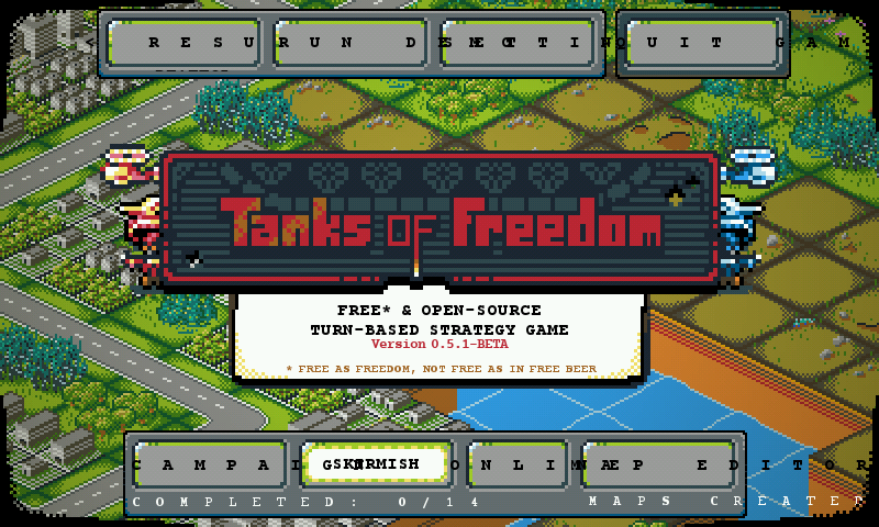

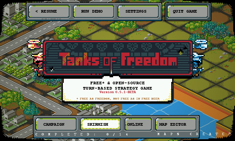

There's a little problem with the menus text rendering.
At least "Skirmish" text button is fine, ;)

That's certainly... interesting. I will tell w84death to have a look at these labels, maybe there is something special about that one that is not broken. On a side-note there is 0.5.1.1 hotfix to add missing translations for android.

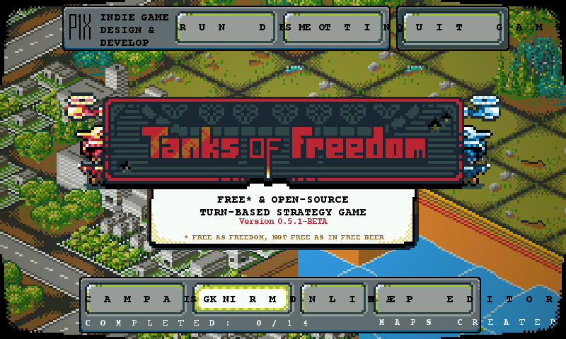

We have inspected this menu, and it turns out, that Skirmish button is ok, because it still uses old way to render font - we have to fix that, so it will be broken for you as well. w84death suggested, that it might be because of wrong handling of TTF fonts, maybe new font implementation on Pandora is not ported correctly (@x1212 ?). Or maybe it just sets wrong default character spacing.

[doublepost=1471938339,1471937315][/doublepost]We have compared these two screenshots, and apparently our change worked... somewhat. It seems, that the font setting is added to the default instead of replacing it. You can try patching your version by changing the font spacing in the theme to something like -15 or more (here: https://github.com/w84death/Tanks-of-Freedom/blob/master/gui/default_theme.tres#L8). You may also modify whitespace size as well if it is still off. In the meantime I will try to figure out if we could incorporate this modified theme into our repository without breaking all other platforms. Or x1212 finds and fixes the issue :)

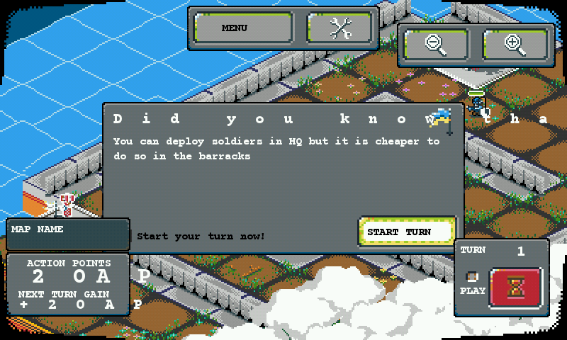

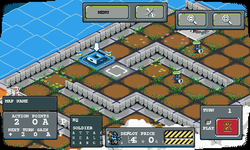

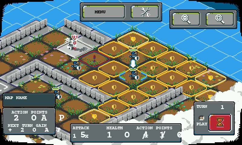

extra_spacing/char = -15 was not enough, so i tried -20 and this is how it looks:
Did you tried to force resolution to 800x480 on your PC? It would be more cheap for testing purposes.

A bit better, but still bad. Yes, we have tried lower resolution - we are always testing each release if it works in Pandora resolution.
I believe we would have to modify all of the existing themes for other labels. I'm afraid it would still not solve issue with labels being off-center. Without finding the root cause of the issue we will not be able to fix this :/
