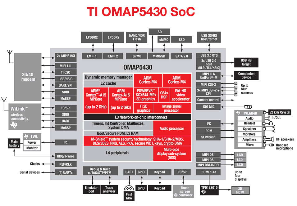

So... working off the theory that it is an OMAP5,  does that mean that this is the general layout and ports that would theoretically be available?
http://images.anandtech.com/doci/4153/omap5.png
Working clockwise from top left corner...
LPDDR2...  2GB RAM?
NAND/NOR Flash...  not using it per the eMMC conversation?
SD... only 1 SD bus if we're using eMMC for onboard storage?
eMMC...  8 or 16 GB onboard storage?
SATA 2.0...  not used or maybe give it an eSATA port?  (would be VERY cool if so)
USB 3.0 OTG... does this get surfaced as the primary USB port OR as one of those wide micro USB 3.0 dual-port things since this is the switchable host/device port?
3x USB 2.0 host...  does one of these come out as our full sized USB host port?  What could we do with the other 2?
4 camera devices?  Skip adding a camera.  Is there anything other than a camera that these could be coopted into doing for us?
Are we using the TWL6040 for audio?  Would that be up to the standard set by the Pandora?
Up to four displays - wow.
Touch screen controller - does it limit to any specific type/style of touchscreen?
Keypad - does it allow for multiple-key-presses?  Or would we be better off using one of the internal USB host ports for an internal USB keyboard definition to get better response?
UART - Fast IrDA - Can we use this this time?  I'd like to have an IR blaster on the Pyra.
(4) serial UARTS - ignore or use for nub (joysticks) inputs?
WiLink - are we going to use the TI wireless solution?
3G/4G modem - quandry.  I don't think we really need cell-phone like capabilities - but it's there on the chip.  I notice a lot of usable signals are being piped to the 3G/4G modem path (USB, SDIO, etc...)  Can we make better use of these (SDIO = 2nd SD slot)?
Fun stuff.
TI is not doing the 5430, only 5432, which is DDR3/DDR3L only.  Technical reference manual appentix A  page 6030
http://www.ti.com/product/twl6040
Edit: TI not doing 5430 is something i learnt from a supplier. On the TI pages the 5430 isnt listed in stock.
