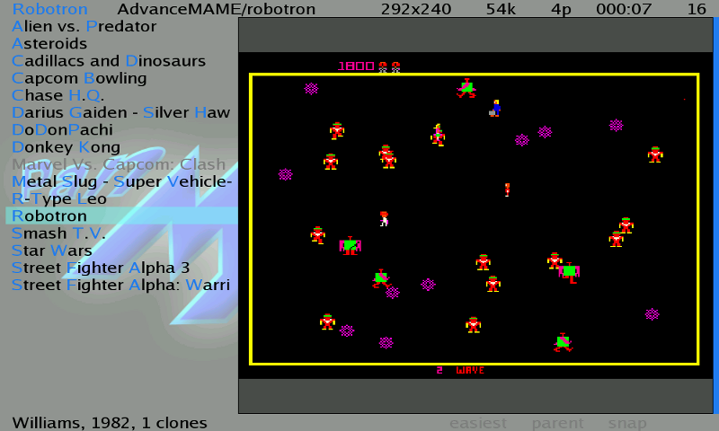

The only thing I don't get...
The picture up top shows the menu screen and a demo of the game the selector is on.
MY PanMAME does not do that.  I just have a blank screen where that demo is.
Do you ever read the description on the repo for an app?
Those previews of the game are little videos in mpng format. You can download them here:
http://www.mamechannel.it/pages/crashtest.php
