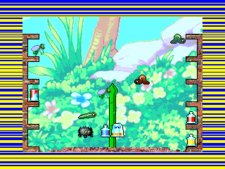

That's not a bad idea, but for now I am going with the Spectrum loading border :
(It loses something as a still image.)
Thank you for putting all this effort up to keep us informed on your progress Mr.Jabberwocky. :)
I think the graphics look really good, well that was until I saw the spectrum boarder. :P
The border looks great when it is running, just like the real thing - it loses a lot as a static image.
