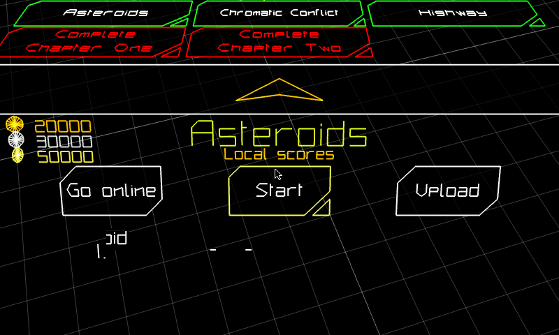

Here's the pndrun.out file: (though it locked up about 30 seconds after the last recorded event)
http://pastebin.com/bm5GcNDx
I'm also attaching a screen-grab from when it locked up. (the game has locked up but ssh/dropbear is still working fine in the background) Please note that the mouse cursor and the letters OID under the 'Go Online' button do not actually appear on the screen, just in the screen grab. As you can see it was as I was loading the 'Asteroids' game menu.
- Neelix
EDIT: I'm running SuperZaxxon beta 5a on a Rebirth Edition unit.

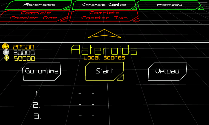

EDIT2: just as I finished saving this message the game resumed on its own. (took about 5-10 mins) I went back up to the previous menu to confirm the game was responding, then selected Asteroids again. It got slightly further this time but then stopped again. (see second screen-grab)
EDIT3: Again the screen-grab doesn't quite match what's on the screen. I can only actually see the bottom of the green buttons, not the top as appears in the screen-grab.
