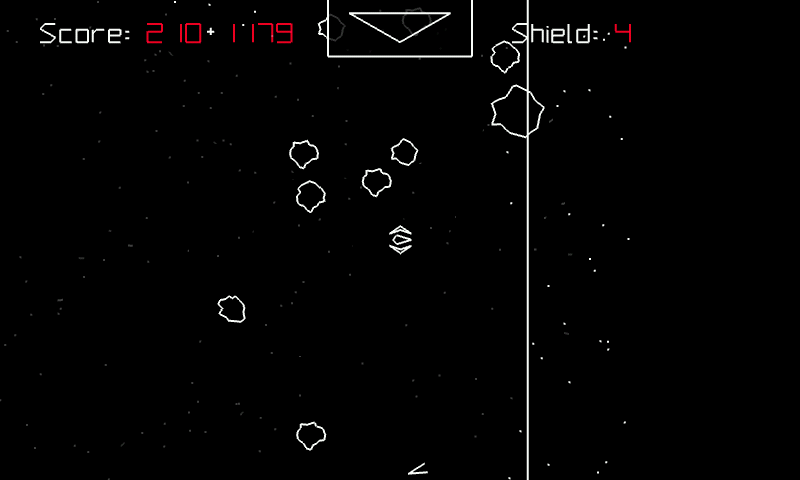

Good job, sebt3!
One small remark: it slightly distracts me to see the touch-screen "nubs" moving while I'm playing; since nobody would play this game with the stylus anyway if you have actual nubs instead, perhaps it is better to just remove the touch controls altogether. My guess is that it shouldn't be too difficult to just not draw them - and perhaps that will even help a tiny bit to make it run smoother on lower cpu freqs.
Ok a new release trying to work around lockups.
I also disabled the onscreen joystick.
if you get a lockup, go into setting and disable : "Play again" screen, Auto-pause. and retry. If you still get one, report again i'll try to see what else ;)

The arraw on the top here shouldnt be there anymore :
else you havent the last one

No arrow symbol appearing at the top anymore but the on screen controls are still showing up as a distraction.
