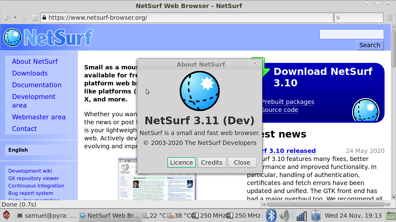

Remember @ptitSeb 's NetSurf port to the Pandora ?
Well, that browser runs well on the Pyra too :D
I just followed that procedure:
The "ns-pull-install" part failed with an error related to some "cast-align" thing, so I ran:
Code:
export CFLAGS="-Wno-error=cast-align $CFLAGS"
...and then that part completed successfully :)
I decided to give the GTK 3 frontend a try, so I installed the required development files:
Code:
# apt-get install gtk-3-dev
And "make" built a lovely "nsgtk3" binary which starts much faster than Firefox ;)
If somebody knowledgeable about DBPs could make a package for the Pyra that would be really appreciated !
Cheers, Magic Sam

Hi all,
@levi : yes, that was the expected outcome :) The latest stable release (3.10) would certainly be a better fit for a Pyra package though.
Cheers, Magic Sam
