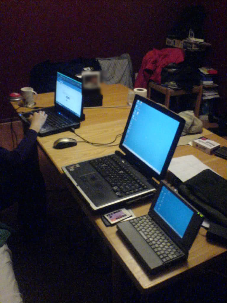

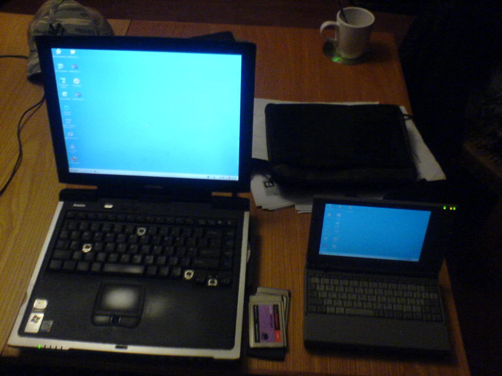

Just showing how small a Toshiba Libretto is compared to another Toshiba...
and another

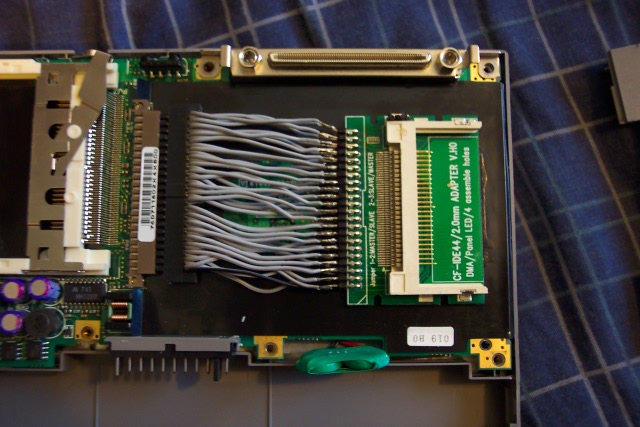

To address how deep the CF to IDE will go into the hard drive slot I ordered some 2 inch long 44pin 2.5" IDE extension (M/F) cables. I got the idea from what this person did: http://www.fineartradiography.com/hobbies/comp/index.html
Maybe I can gut a bad laptop hard drive and mount the CF adapter on the frame so it can slide in and out like a regular hard drive. I’m trying one last format on a bad drive I have before it goes under the knife.

I have this type of CF to IDE adapter and ended up cutting the pins down like this person:
http://www.josephn.net/solid_state_libretto
http://www.josephn.net/images/cf_libretto_images/cf8.png
I added a long strip of packing tape doubled over on the end so I can pull it out.
This also made it easy to guide in.
The problem is the Libretto won’t recognize the CF IDE drive. It just hangs at startup.
The CF to IDE adapter works fine with my USB to IDE/SATA adapter.
My CF to IDE adapter is rev.B1 with black plastic for the CF slot. The ones used in those two pages above have white plastic and the first one is rev.H0 so it’s likely that I have a different version.
