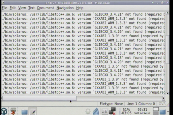

..i try now to port the newes Zelda Solarus Game named "Zelda-The Book of Mudora" :)
[doublepost=1486855912,1486848802][/doublepost] Help,what does that mean?
probably you forgot to copy the libs inside codeblocks into your pnd.
They are newer than that installed on Pandora's Nand so it need to be copied into every pnd.
Hint : use copy_libs.sh script inside codeblocks cli.
go to dir of your compiled game where you create a pnd of it.
type
mkdir lib
cd lib
and then type
copy_libs.sh ../XXXX (where XXXX is the name of the executable)

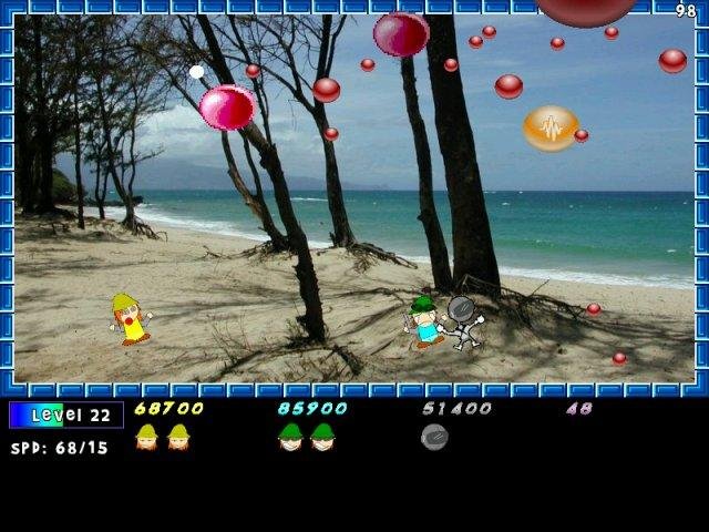

Someone please explain how port this game PangZero (coded in Perl + SDL) and licensed GNU GPLv2
1
I made a tentative but failed adding SDL into perl.
You mean, command like
Code:
cpan SDL
from codeblocks command line doesn't work?
Anyway, the packagign of a PERL program will probably be tricky!...
oh i had Problems too installing the Perl XMP Parser.i think there are some Files which we cannot change for Installing Perl Things.
Is there a Way to use the entire Codeblocks PND unpacked on the Pandora on an Ext2 Partition?
My SD Cards are Big enough,that should ne no Problem.
Can you please post the excact Command for unpacking it on the OpenPandora directly?
This is what happen when i type cpan SDL on codeblock's shell
cpan SDL

Killed... Seems like you need more memory, install a swap file.
Also, you can probably try to update cpan itself, with something like
Code:
cpan CPAN
(I'm not sure, but it should works)
Never imagined that Perl needed so much memory...cpan SDL work now...it's installing (long procedure this installation)....i'll let you know when it finish.
