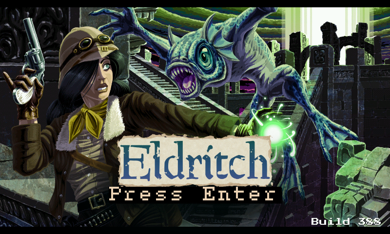

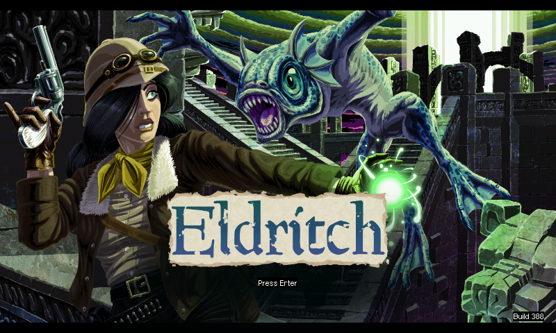

I finally have a picture (and sound), but I doesn't accept my keyboard input :'( So I'm stuck at the Intro screen, with "Press Enter"...

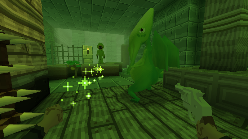

Finaly got Eldritch to run.

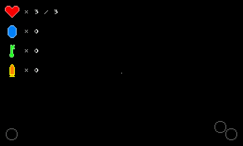

I got to hack the source to make it runs with newer dataset (as Steam doesn't have the ability to Downgrade a version). Now, the Start screen has proprer sized text, react to my keyboard input, etc...
But I was than greated by a superbly black gameplay screen :'(

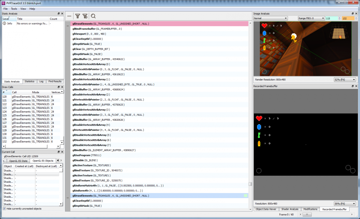

The point is, Eldritch is an OpenGL 2.1 game. It wants shaders. So for this port, I hacked some OpenGL2 -> GLES2 messing, that kindof work (plus the shaders are part of the game assets, and so are no free to distribute, so I have to patch them on the fly)... But a Black game play? I recorded the game with PVRTrace, and saw that ... it works in PVRTrace !
After a few hours of messing and testing, I found the issue: most of the gameplay is rendered in a Framebuffer (and than blitted on the screen with a sophisticated shader that handle Gamma correction). The Framebuffer is set to screen size, so 800x480. Even if GLES2 do support Non-Power of 2 texture, and that the SGX also support NPOT extension, it seems Framebuffer doesn't support being a NPOT size ! So I set the size to 512x256 (to get some speed), and it worked!
And as you can see, the small Framebuffer doesn't alter the rendering too badly. I have set the filtering to GL_NEAREST, so get Pixels. I think it fit the art of the game quite well, so I will probably let it like that.
For now, it's still a bit slow on my Gigahertz. I'm try to find ways to accelerate it (like remove the blit "gamma" shader and put a simpler one, and use hardware Gamma instead).
I hope to have some beta PND soon. If some are interested in beta testing (you need the orignal game of course), give me a PM...

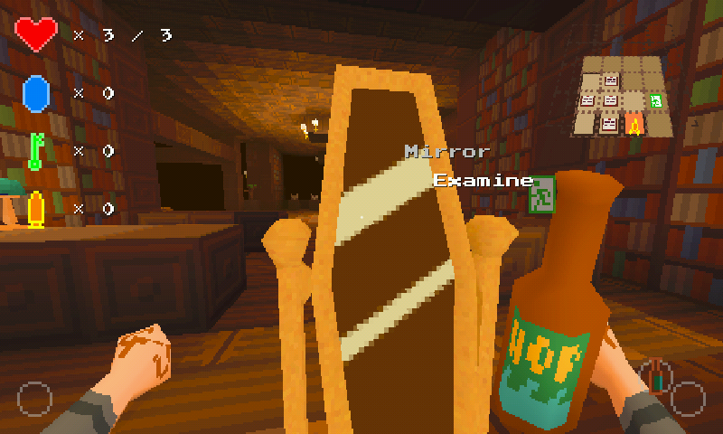

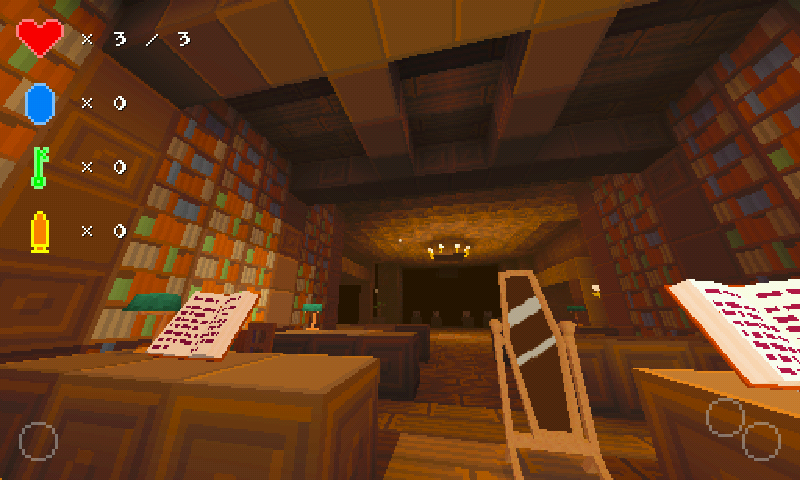

Btw, I have fixed my missing hands and corrupted books...
The game use "row major" Matrix, where OpenGL, internaly, use column major.
So, when loading matrix into uniform, it uses the "TRANSPOSE"  parameter. Of course this is not supported on GLES, so (early in the port), I had to write a manual transposition of the matrix.
The point is, the game load more than 1 matrix at a time (like 7 for example), and my simple loop worked only for 1...
Fixed now, it looks good (but still slow)...
I got to hack the source to make it runs with newer dataset (has Steam doesn't have the ability to Downgrade a version). Now, the Start screen has proprer sized text, react to my keyboard input, etc...
