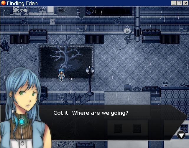

I found an Opensource RPG Maker XP and VX player for Linux like EasyRPG.
https://github.com/Ancurio/mkxp
So it's not a straight forward compile in fact.
I had to compile SDL2_sound (done),, libguess (done) and update Ruby to 2.1 (on going), even if it can be run with ruby 1.9, it's strognly advise to update...
After that, I suspect the packaging may be triky (because of that ruby binding).
But the way @ingoreis, do you have link to some free games to tests, in case all goes well enough...
Any little News of this,where you able to play on of these Games? ^_^
Still nothing. It segfault at start (of "finding...", didn't try any other). I tried to debug a bit but I'm not sure where it segfault (there is 2 thread, and one is ruby, it I think it's segfaulting on this one, but not sure). I used gles2 rendering also, as it is supported...
Maybe I have to try some other games you linked..
