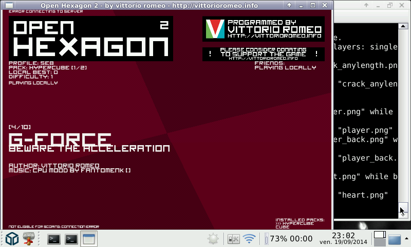

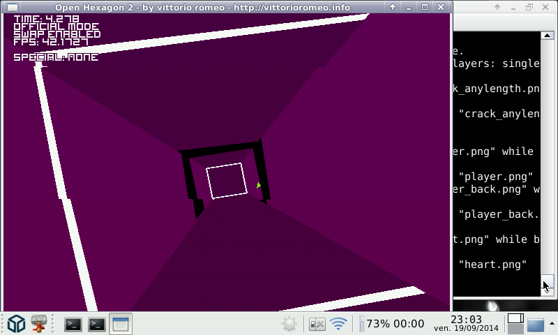

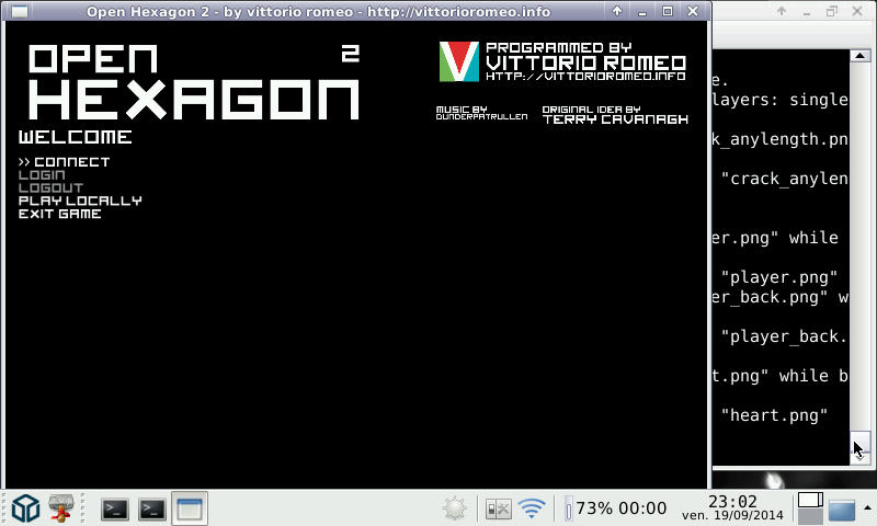

Fixed texture issue in OpenHexxagon! :)  (SFML create multiple GLContext that are supposed to share texture).
Will try to publish this WeekEnd if all goes well
